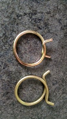

I'm having a tough time installing Corbin hose clamps on my radiator hoses on my 69 road runner. I have a decent pair of hoseclamp pliers, and have put some WD40 on the hose. The clamps seem to get wider but not higher, like an oval, when I squeeze the clamps. Do I have cheap clamps, are there a better brand? Am I missing something??
Sounds like they might not be the right ones, IDK. They should expand and slide over the hoses, with no lube and once in the right place, all should be good
mine do the same thing....yours might be the wrong size clamp, or the hose it too thick
Are the Corbin hose clamps pliers ratcheting that you have. Makes a big difference when you are spreading the clamps. The clamps should all be the same, where did you buy them?
Get the snap-on pliers and life will be good. Also note that the original size clamps are often one size too large for the heater hoses and sometimes ever the radiators hoses as well.
I use a good set of large channel locks with deep teeth to get the larger ones on, seems to work great, just be careful not to send one flying!!!!!
You might try putting the hose clamp up on the neck of the fitting, slide on the hose, and then slide the clamp back-into place.........................................MO

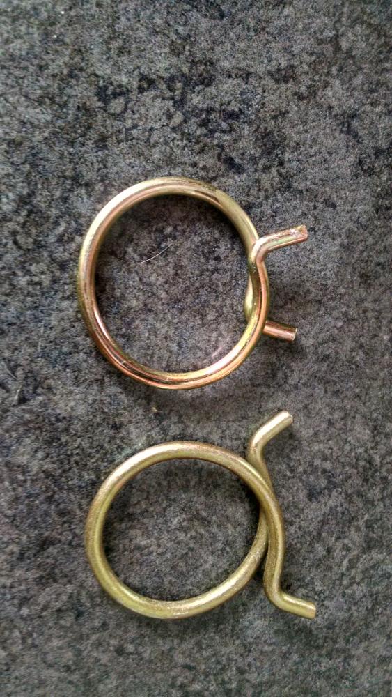

I think I found my problem
After some frustration, I've discovered that not all corbin clamps that are on the market are the same!
The one on the bottom of your pic looks good, the other can go in the waste bin!!!! I have a few that were like that as well.
