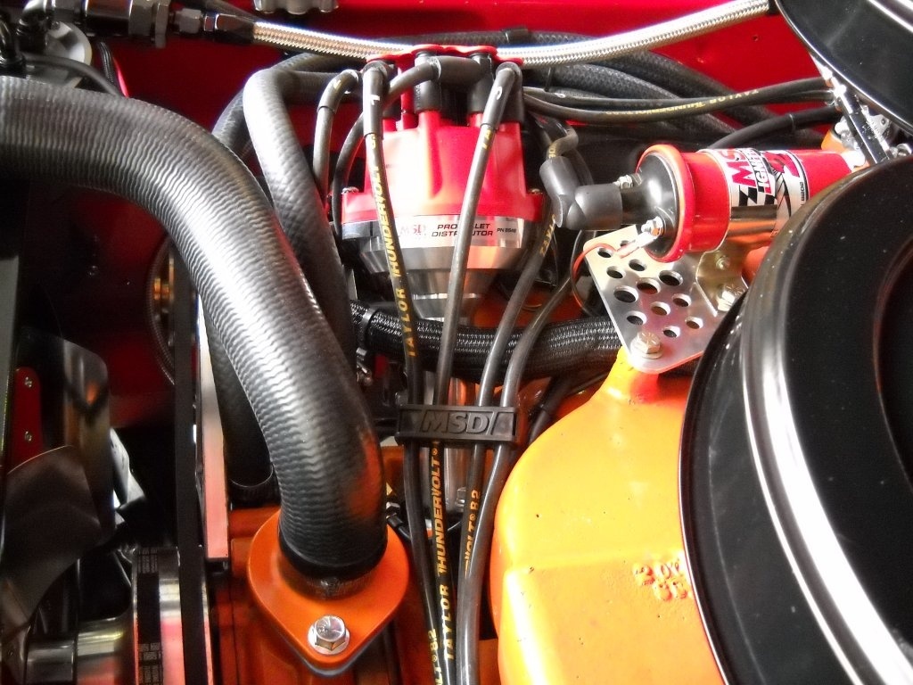

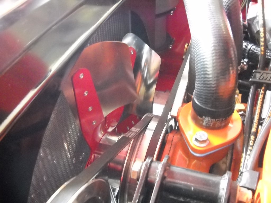

When servicing these cars since way back, I spread a little Indian head around the perimeter. No comebacks for leaks.
