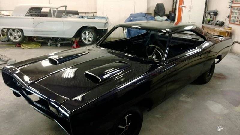

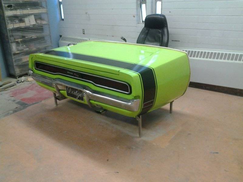

It would be fairly easy to do. If the car needs a trunk floor pan,just put a Charger trunk floor pan in it. If not, just measure where to cut the hole in the trunk floor of a Charger. Then install a Charger gas tank and filler tube.There are many people putting new full rear quarter panels on second generation Chargers, so I wouldn't think that it would be too difficult to get the filler cap area out of a discarded Charger panel and graft it into the top of the Coronet rear quarter panel. I made my desk out of panels that I cut off of one of my Charger projects.

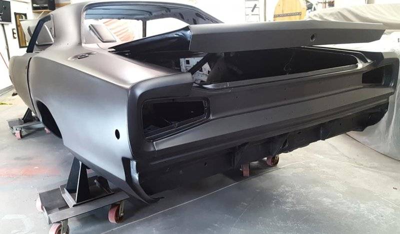

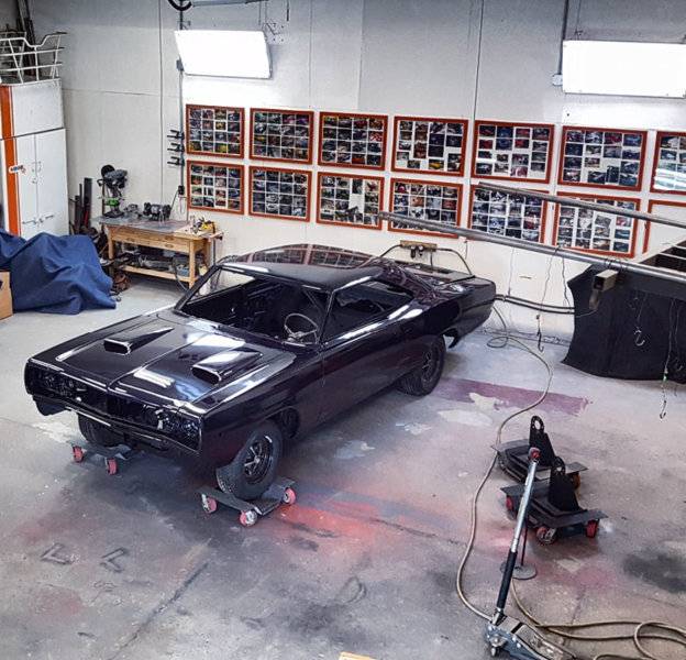

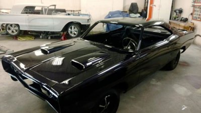

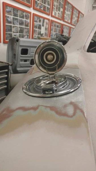

Thanks for that link, I was hoping for a shot that shows more of the car, and at different angles. Those pics were too close for me to tell if it fits with the car or not.
EDIT: I looked more into that site and found some better pictures, but still unsure.
As for my car, it's had collision repair back in the day and wouldn't be a good candidate for restoration. It's a base model 440 trim car. My plan is to fix the rust and put a cheap paint job on it and drive it. It needs a l/h quarter skin, outer wheel well, and a trunk floor.
I already have everything to make the swap except the trunk floor (old qtr, tank, filler tube). So I need to know which way I'm gonna go before I order the floor.
I prefer gassing up with the Charger filler vs behind the tag, But if it looks awkward, I won't do it.
