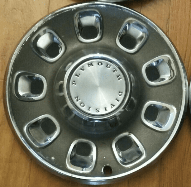

I believe my '69 RR came with full size hubcaps. I have seen two different hubcaps that claim to come on RRs - very similar to each other.
Option #1 has a silver center and the letters look like they are stamped down and painted black.

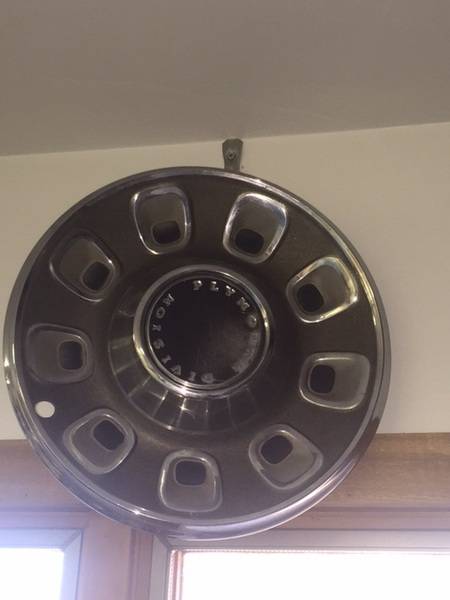

Option #2 has a painted black center and the letters look like they are stamped up and not painted.

Option #1
Option #2:

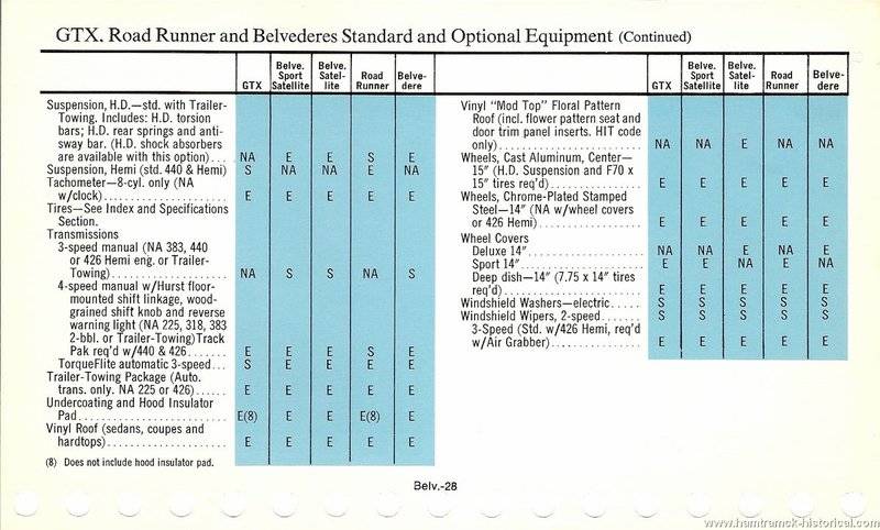

Availability by model.
Is the top cap a 68 maybe? I have seen similar caps on the 68 C bodies before. Maybe the center color and small changes were a year thing from 68 to 69? Just a guess.....
