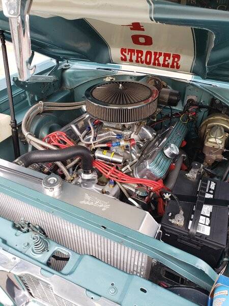

You needn't go to all the work of checking codes, etc. The correct block color for a 66 383 or 440 is the turquoise. I have it on my 66 coronet. You can look at it on the pics of my car "007dodgeboy"
Turquoise is the correct block color for a 383 or 440.

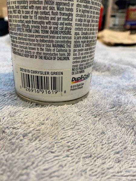

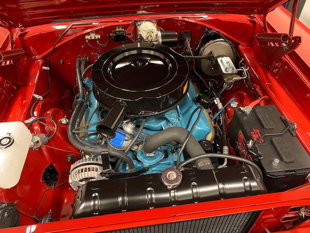

#1Charger, this is what I used for my car and the result. B. Oh Mike, I did scrounge up a different Battery and Hold down. :-)
