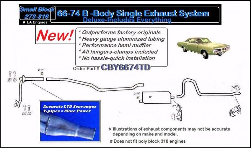

Title pretty much sums it up. My '68 Satellite came to me minus tailpipe (on order); but more importantly, the hangers for the tailpipe and the muffler are completely missing. This is what I'm working with (excuse the picture, but it's the best I could get outside at night):
I've seen a few hangers on eBay, but haven't been able to pin down what's what. I know one bolts up to the bracket under the rear seat floorpan area, and the other bolts onto the framerail - and I don't know whether it bolts to the side of the framerail (Ford style), or whether it'd be identical to my '69 Valiant, which bolts to the bottom (in which case, there's only one hole in the frame that it could possibly mount to).
Anyone have any pictures or hints that could guide me here? It would be much appreciated.
-Kurt
I would say so, but call Accurate Exhaust because those are sold in pairs.
Do you have the floor pan bracket to hang the muffler hanger?
Will do. I think I've found something closer to the drawing though - probably for a smaller pipe though (given that it's for a Slant 6):
http://www.ebay.com/itm/NOS-MOPAR-1...TER-/380419716345?hash=item5892c834f9&vxp=mtr
Note that the illustration shows a single band of rubber bent in a C shape, not the O-shaped rubber as on the Hemi repops. I can't see it making much of a difference, but it's worth noting.
