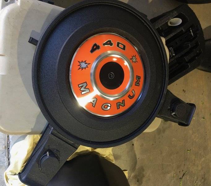

Local shop blasted mine and powder coated it in the wrinkle finish for $75. He said he had a bunch of motorcycle stuff to do with the same stuff so he cut me a deal I believe.
$75 is a deal
Looks great
Had mine powder coated around ten years ago for the same price
Best thing I could have done honestly , still looks brand new
Got another quote for a friend was over $200 based on blasting
But like you said if they can do the same product on multiple applications , just have to ask
$75 is a deal
Looks great
Thanks! I was willing to pay the $200 because I heard that’s what about everyone was paying to do one because the end product turns out great
