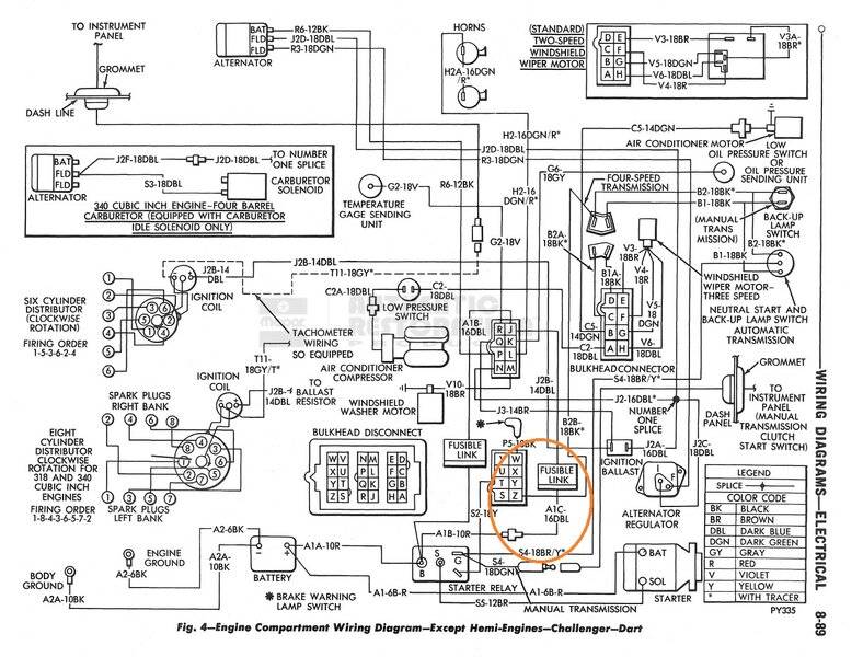

Hello,
Posted this on FEBO and thought I query the FBBO gang...
My 70 challenger has an original dark blue or black Fusible link.
Does anyone know what the color and size this link is?
I suspect it's either 16 or 18 Gauge.
I'm considering purchasing a spare
Many thanks

The original fusible link is 16ga. DBL is dark blue.

Fuse links can be found on auto parts dealers way cheaper than from restorer shops. Depending on how picky you are could be find on diff colors, with and without the label, with and without terminals matching your setup. You can get the fuse links on pieces or even rolls. So depending on your skills you can make your own fuse link setup in 1/4 of the restorer shops prices and even get spares ready to go.
Thanks,
I was able to locate a fusible link (black not dark mopar blue) on Ebay which was perfect as a spare and much cheaper.
