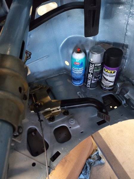

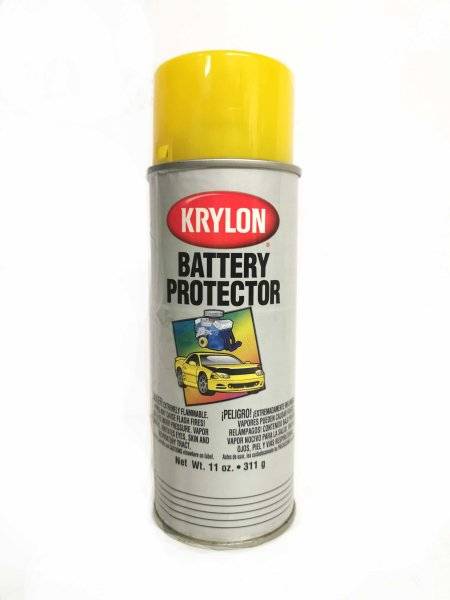

Since a few folks have reacted to this post I guess I'll explain a little more in-depth...If you'd like a product that looks like Cosmoline but isn't sticky & is more durable look at Krylon Battery Protector... I used it back in 95 & the control arms still look good 27 years & 100,000 miles later...
BTW, First I use Seymour Stainless steel paint as a base under the battery protector....
Back when I came up with this method I'd bought Cosmoline in a spray can... It looked horrible & it didn't dry, stayed sticky....
I was looking for something that looked like real cosmoline which I'd seen plenty of haven't spent time in the Navy where they store lots of old stuff & that stuff is exposed to salt water...
I tried a few things then remembered how the battery protector stuff was a transparent yellow/brown depending on how much you apply... Which means you can lay it on till it's mostly golden with runs that are brown.. Just like real cosmoline... But it's acid proof, not effected by harsh cleaner, dries to the touch in about 15 minutes.... After I posted about itt back in 2003 or so I got lots of guys trying it & saying it was the best fake cosmoline they'd ever tried....
