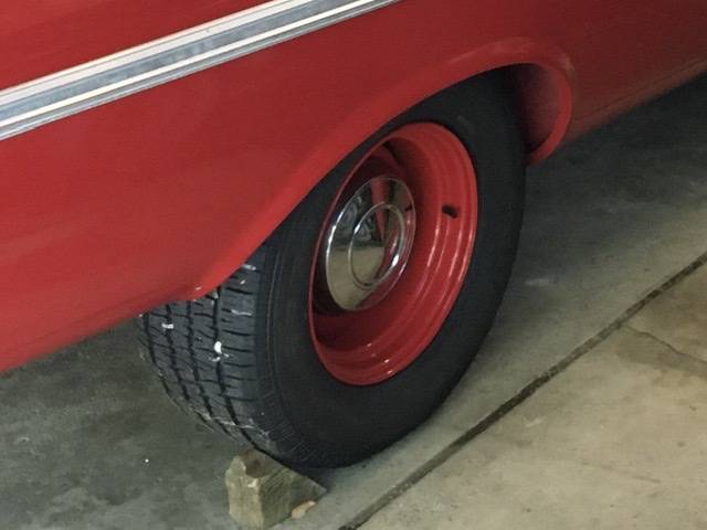

Just bought a 64 fury and previous owner put 15x8 Ram-Charger rims on back and standard 68+ steel rims on front to match . He had dog dish center caps on them but glued nylon spacers on inside to make them fit....what’s correct size dog dish cap for the Ram-Charger wheel and where can I get them?

pic's of the ram-charger rims
9 3/4 caps are on in pic and come off when hitting bump with spacers...I saw some 9” ones in the for sale section.
The 10" caps are correct for a 64. The wheels you have use the 9" caps. I personally don't care if the caps are "right" or not, I just love the look of either.
I'm using 67 cuda caps on my ramcharger rims on my 62. 9".
I think the nicest 9" cap for early Plymouth is the raised centre '68 cap. I know they are kinda hard to find because the Roadrunner guys grab them up. The '69 cap changed and went with "PLYMOUTH" letters on it.
