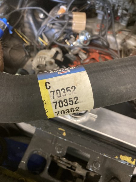

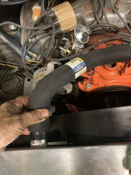

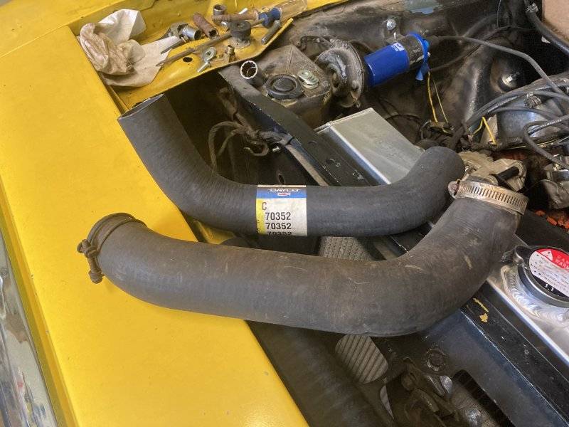

Anyone have the part number for the proper upper radiator hose for a 71 GTX 440 with a 26 inch radiator. The old one I had was an old Chevy lower that I cut the end off. The new one from Rockauto curves the wrong way on one end

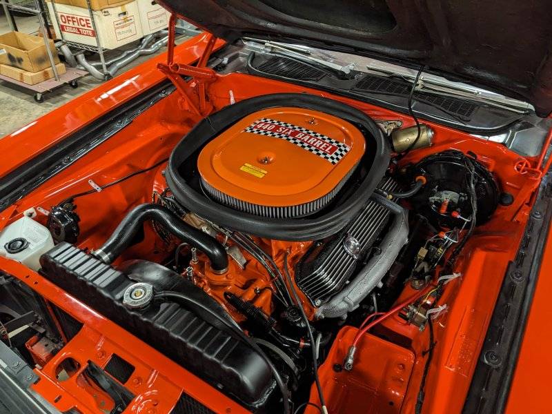

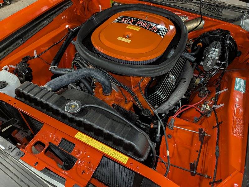

The Dayco 70352 seems to be made wrong or listed wrong for this application. Your aftermarket radiator hose inlet looks close to the stock radiator location. The Continental 60664 fits this application. The 60664 has an upkick bend over the alternator area. The Gates 20630 also fits and is routed more directly to the thermostat housing.
The following images show the Continental 60664 and the Gates 20630 on the same engine.
Continental 60664:
Gates 20630:
Other brands' interchange numbers should be the same, but some might not be correct, as in the case of the Dayco hose. These specific brands and hoses I have used on this car. I generally prefer Goodyear or Mopar, in the past, but now I usually choose Continental. Continental purchased Goodyear's automotive hose and belt division, which was the vendor for the Mopar branded replacement hoses.
