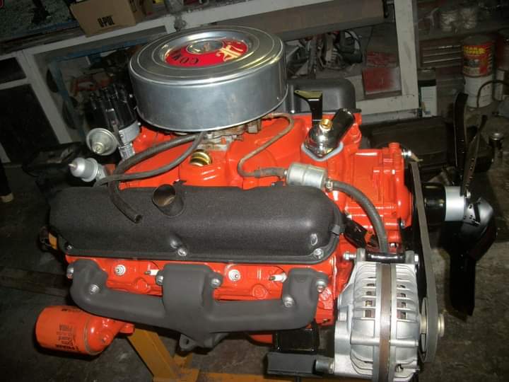

Powder chrome has made lots of advances in forty years but it still doesn't replicate a good old triple-plated chrome job.
It will be most noticeable if you have real chrome visually near it (such as a chromed master cylinder cover) but you can squeak by otherwise.
I rarely shoot it except as an accent color but here's an old 2011 pic of @waggin's dad's 273 air cleaner I had the honor of restoring for them to help your visual.
