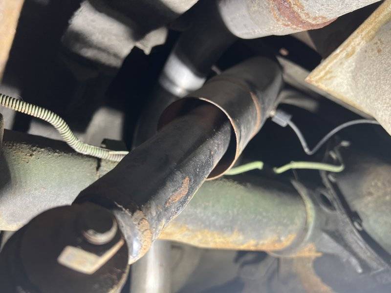

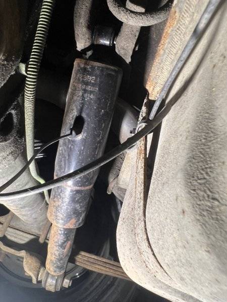

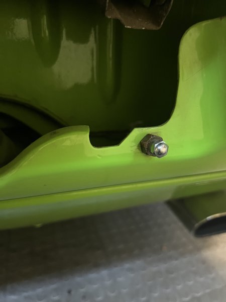

I have a 72 RR that is new to me. I can tell that the left side of the car is a little higher than the right side. I was thinking it’s possible how the air shocks are adjusted. I just have no idea how to adjust them. I only see one nipple that maybe I could hook up my compressor to but how would I adjust each side? Or how would I let all the air out to them start at level before raising them again? Also I’m just assuming this is for the air shocks I guess I don’t know for sure. It is right by the license plate
Get under the car and follow the air lines from the shocks. Some are on one line and some set ups have a line for each shock. If they are on the same line, there is no way to adjust the pressure from side to side.

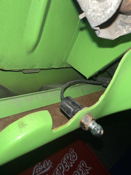

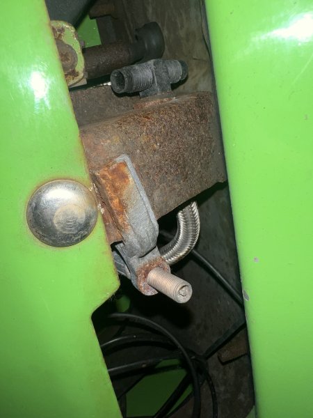

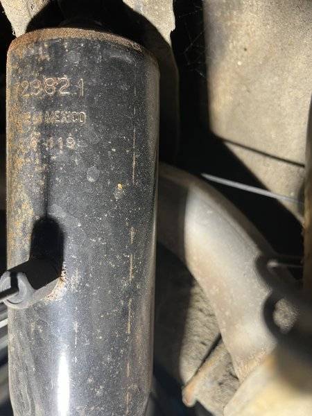

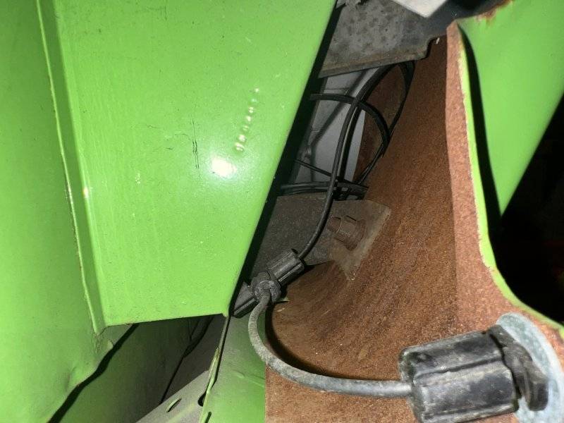

So it looks I have a line from each shock. Then I have that nipple under my license plate and I found what looks like an air pressure stem under the bumper. I’d imagine one lets air out and the other lets air in? Would I just let all the air out and then fill it back up to the height I like or is it likely that one of them is broken and that’s why it’s slightly off kilter. Why wouldn’t there be two separate fill spots to air them up.
These let air in AND out just like a bicycle tire valve stem. Let air out by pushing in the pin in the middle, put air in using a bicycle pump or compressor. I can't see the whole system, so you just need to put air in and out and see what happens to the height on wither side or both. Don't drive on the shocks with zero air or more than maybe 40psi. You won't damage anything airing them up or down and experimenting.

Got it! Makes sense. Sounds like I might need to replace these sooner than later. I get the valve stem under the bumper is to take air in/out but any idea what the nipple is near the license plate is used for? I was thinking it looks like if I was to loosen it air comes out?

If you have a single line and one side is lower than the other, something else is causing your lean to one side. Weighting the high side is not the ideal solution. You haven't mentioned checking the pressure at the 2 nipples. Check them then equalize the pressure and see if the car is level. If not, look for another cause. You also didn't say that you traced those 2 lines back to the shocks. If they each go to one shock, my guess would be that they located them differently for ease of routing.
