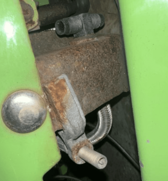

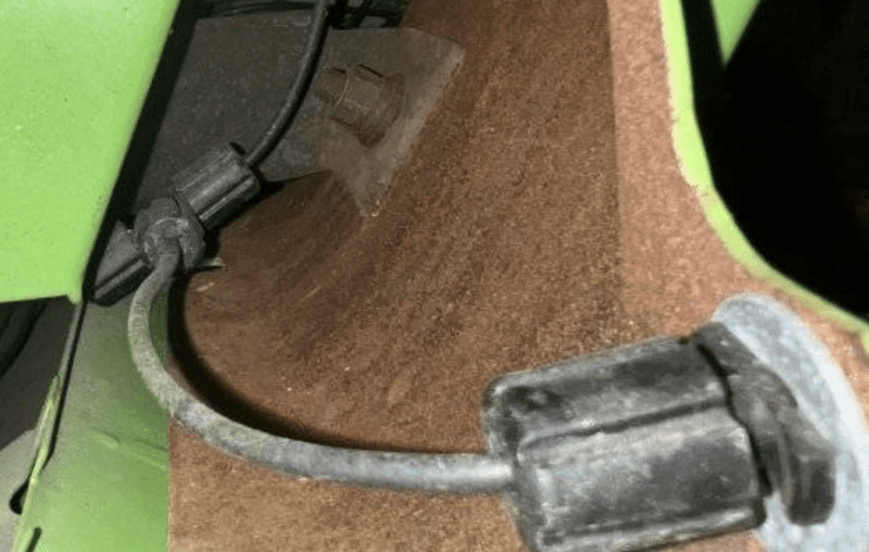

Got it! Makes sense. Sounds like I might need to replace these sooner than later. I get the valve stem under the bumper is to take air in/out but any idea what the nipple is near the license plate is used for? I was thinking it looks like if I was to loosen it air comes out?

It looks like you have some leftover hardware on that car. The air fitting by the license plate goes into a tee fitting and from there two lines branch off, one line goes to each shock. You can follow the lines to confirm that.
The corroded fitting under your bumper looks like it did the same thing at one time, but there is nothing hooked up to the tee fitting anymore. As Remcharger said, maybe someone replaced the air shocks with a second set and left the old fitting in place. Or maybe someone re-plumbed it because the fitting leaked, or they got tired of fumbling around under the bumper to air up the shocks.
