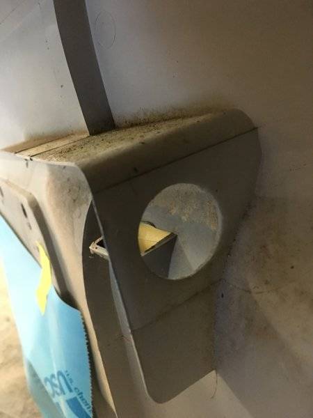

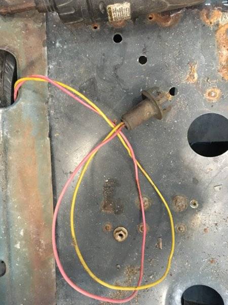

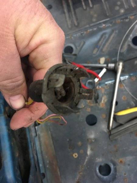

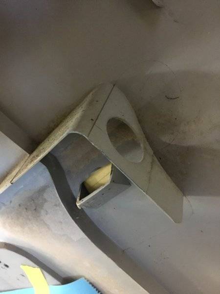

First is a close up of a socket. I think they are the same as console light sockets if you need to find replacements. Second is of the location of the left side wiring. The right side is taped to your top pump wires and then crosses over and down in front of the wheelhouse. Last 2 pics are of the backside of a trip panel. The sockets just clip into the round holes. Hope this helps
It absolutely does help. I can’t thank you enough for that effort. Now I ll know what to look for. Hopefully, I can manage to find some if mine aren’t there. Was there a lens that went over the square hoe on the panel ? Those lights are pretty important on a convertible. Having no dome light.
Hole, not hoe. Lol ! My holes aren’t round, they small squares. About 1 square inch. I don’t see those sockets being able to clip on anywhere. Maybe my sockets are much smaller using smaller bulbs ?
They don’t clip into the square hole. They go in the round hole that is in behind the panel and just shine through the square opening. The pic I sent is the backside of the panels. No lenses that I know of. I’ve had 3 sets of interior panels during this project and none had lenses in those openings
