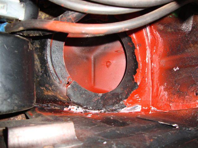

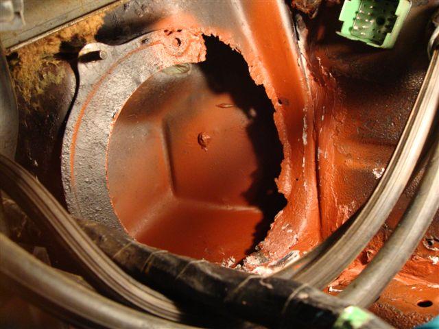

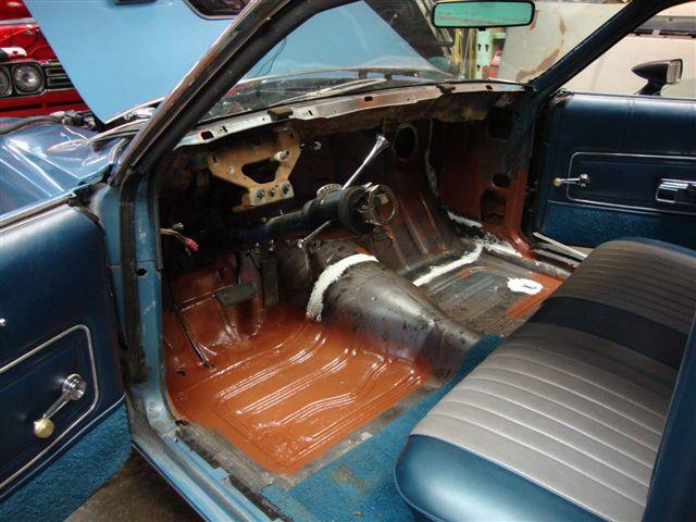

Cowl rust is probably the one problem area that will affect you the most and that's because your interior fills up with water. I don't think a hole here and there is going to affect the structural integrity of the car, provided the rust hasn't eaten away at the spot weld joints along the whole piece. So if you just have that annoying hole that lets water in the car you can fix that a number of ways.
Using my old 71 Ranchero as an example here is what I did. In the pics you will see the vent hole (actually capped from the factory) that is supposed to have a nice round hole but the right half is eaten away by rust. I made a template out of thick paper then transferred that to a piece of sheet metal. I had several choices for attaching the sheet metal and ended up using what I felt would yield the best results. A couple of sheet metal screws and rivets to make a good mechanical joint then JB Weld to seal the seam and small gaps. Welding was out of the question because no way I could remove enough rust to get a good weld, so I wire brushed then treated the metal with rust converter and applied some good 'ol Rustoleum. Figuring I had a pretty good bond between metal and paint I proceeded with the epoxy and installing the patch. After that set up I used a variety of flexible sealers, sprays and mud on the water side of the joint to make double sure nothing got through. Put the factory cap back on with a new foam gasket covered with the right stuff sealer and I'm ready for Portland OR weather. By the way, I did this with the dash removed, which made it MUCH easier to get at.
