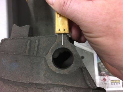

The end valve cover bolt holes are nowhere near the cooling passages?
Huh.
The factory used studs in those end bolt holes.
I’d suggest you do the same for that leaker.
Just use some silicone on it before you put it in.
