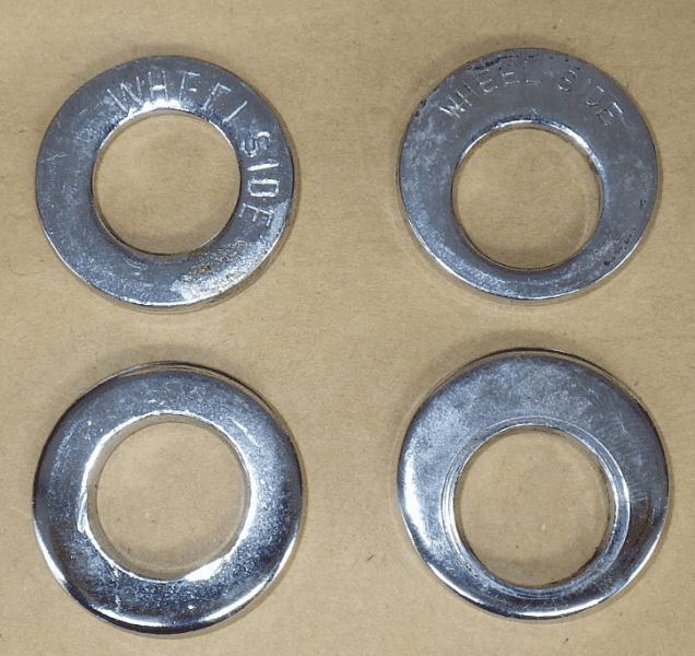

Bought a set of used uni-lug Cragars but no hardware. I see that, depending on the source, the "special" washers needed are either flat or concave. Does it matter which is used? Thanks!
They are either offset or not depending on which bolt pattern, the guys at lugnut king know which are which
The Cragar unilug takes an oval flat washer with the hole offset to one side.
I agree with post #6
I had a set I bought 30 or 40 years ago and the inner hole was definitely offset and you flipped them around for different wheel lug spacing.

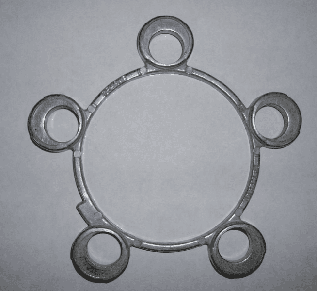

What I didn't care for on the offset washers is they tend to spin as they were torqued down. My old 10 X 15 Cragar unilug SS wheels didn't have recesses for the washers but they did have the crappy inserts for the lug pattern which always cracked on ya'.
Beveled washers can also be somewhat of a locking feature.....................
Ring from post on JJ ...
