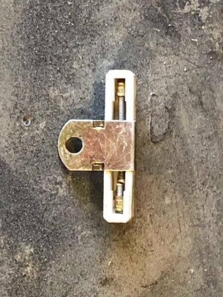

This happens with my 75 Power Wagon but also used to happen with my Charger.
The first thought is to blame the ignition switch. I've plugged in 2 other switches and still had the same problem.
Crank and crank....no spark but then just as the key is released to the RUN position, the engine tries to start and snorts up the carburetor and air filter. Sometimes I time it right and release just in time and the truck fires up. Other times the truck starts normally like nothing was ever wrong.
I have wiggled the wires to the ballast resistor and had it fire up immediately afterwards. I have replaced the ballast resistor and it has fired up normally.

One day I can walk out to the truck and it fires right up. The next day, it spins and won't light. What changed from day to day? Can a ballast resistor work only part of the time? I had one that worked fine in the Charger. It was idling in the shop then I shut the hood and the engine stalled. The vibration must have damaged the BR because after looking at several things, when I pulled the BR off, I could see that the spring on the back side connecting the two terminals was broken.

Ballast resistor. Get a couple from @HALIFAXHOPS. You may never need the second one. Your truck should have a dual and your Charger a single resistor unless it has been changed. Also check the power feed wire through the bulkhead connector.
OK Only in the run position can only be in that circuit. So if your running a double ballast the run side is either open or it is THAT SIDE of the ballast wiring think of a ballast like a blown fuse. Easy check see if one of the terminals gets 12 VDC in the run position. If so and the other side does not have any voltage it is a ballast. Do it with a volt meter a ohm meter can show good if it looses it under power. If it does not you have to start chasing it from the ballast back. Check the connectors first and when apart see if the termina for the run position has 12V. If it does problem in the engine compartment if not have to shoot the wiring inside the car. Start at the ign switch and see if it lets 12V out with the key in run. FSM should have the wiring diagram.
