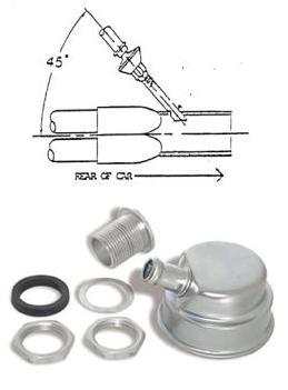

I am soon to install some Hooker ceramic coated headers and I will be needing to weld nipples for the Moroso crankcase evacuation kit into the collectors. What should I expect and what procedure should I follow when I attempt to weld with the ceramic coating in place?
Yep, use a flap/sand disc to remove the coating around the spot before welding. Mine are in the collector on about a 45 deg angle.

You are going to have to get down to bare metal around the bung you are going to weld in ( grind / sand ). You can't weld on that coating. Then just heat paint the area to match your coating color. Best you can do.

I'm not sure how it effects the efficiency of the evacuation system but you can weld the evac tubes to collector extensions.

What do they recommend for the pipe fitting that is welded into the collector as far as cut it on an angle or leave it straight ?
Mine are Moroso and they came cut 45 degree's I do believe.
Yes, install at a 45 degree angle with the angle cut being parallel with the tubes. If you want to increase the integrity of the seal, install positive locking breathers that are threaded as opposed to a grommet/push in type breather.
These Moroso breathers have the baffle built right into them. I also put the tubes in the collector after the header. Setup works great. Had to drill my own holes in the valve covers. Used painters tape for protection and a step drill bit. Worked perfect.
