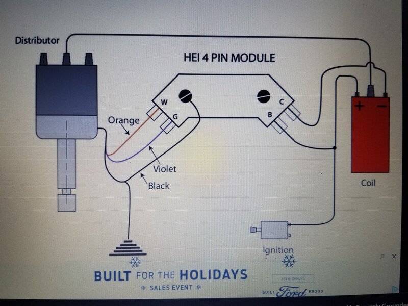

Maybe I missed it but I don't see any reference to how your fuel system is set-up. Would you please elaborate? Do you have the BLUE Fitech wire hooked to the 'tach' terminal on your HEI?
I am using a DUI HEI system, Stock electronic distributor with a HEI module connected to an aluminum heat sink underneath and their coil. I connect the blue Fitech wire to the negative on the coil for tach signal.Maybe I missed it but I don't see any reference to how your fuel system is set-up. Would you please elaborate? Do you have the BLUE Fitech wire hooked to the 'tach' terminal on your HEI?
A DUI HEI tri power distributor is a factory electronic distributor w a HEI module attached to it on an aluminum heat sink. Very simple, the pick up could attaches to one side of HEI module, then the other side of module atraches to the factory style 45k coil. Per Fitech instructions, blue wire connects to "tach" output on large cap HEI distributors. Small cap, what I'm using, the blue goes to the negative on the coil.You do have to have spark, but supplied at the right time and intensity. Check out Page 6 of your Fitech Installation Manual. "Required only if timing control is NOT used". On HEI distributors, the BLUE wire hooks to the TACH terminal on the module. Does your DUI distributor have a tach terminal? If so, move the blue wire to it.
Also, your fuel system?
And I would be very careful about 'jumping' connections on EFI. Very easy to crap the ECU. These aren't carburetors...

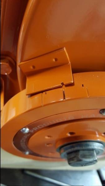

The slot on the intermediate shaft is cocked a little left or a little right of being lined up with the crank shaft depending on which tooth I drop it down on but it will not line up exactly in line with the crank shaft. I went with the front of the slot barely pointing toward the passenger side, "little right". At that point, valve cover off, both valves closed, finger pushed out of #1 spark plug hole, hand rotate last couple degrees till zero on new Fluid damper SFI balancer lined up with the timing tab. At that point, I can rotate the distributor about 10+ degrees retard (counter clockwise) and well over 20 degrees advance (clockwise). Is it possible that the new balancer and pointer are not exactly at 0? Should the intermediate shaft be lined up exactly in line with the crank shaft at TDC?So with the slot lined up with the camshaft at tdc on #1 you still don't have enough adjustment area?
Yes, exactly. I was just wondering if my timing pointer or balancer my be off and I'm adjusting from an incorrect 0 degrees. I'm trying to find a piston stop in my hillbilly tweeker town and called all 4 stores and no one has one. Guess I'll be ordering one and waiting 2 weeks so I can verify TDC on the balancer/pointer and then verify the distributor.Unless you are building a 'factory correct' engine, it makes NO difference where the slot in the shaft is positioned. What IS important is that when the motor is on TDC #1 compression stroke, the rotor is pointing at the #1 spark plug terminal in the distributor cap...
Really depends on if you are using a vac advance on a bb or not. There's a limited adjustment range before interference with heater hoses, coil, plug wires, etc. The advance canister pointing towards #1 plug is pretty much a happy medium for that adjustment along with room for the hose. I have mine @ 16° btdc at idle and it still points towards #1.Unless you are building a 'factory correct' engine, it makes NO difference where the slot in the shaft is positioned. What IS important is that when the motor is on TDC #1 compression stroke, the rotor is pointing at the #1 spark plug terminal in the distributor cap...

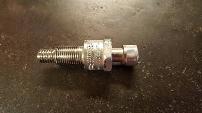

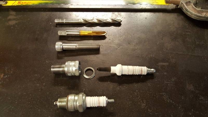

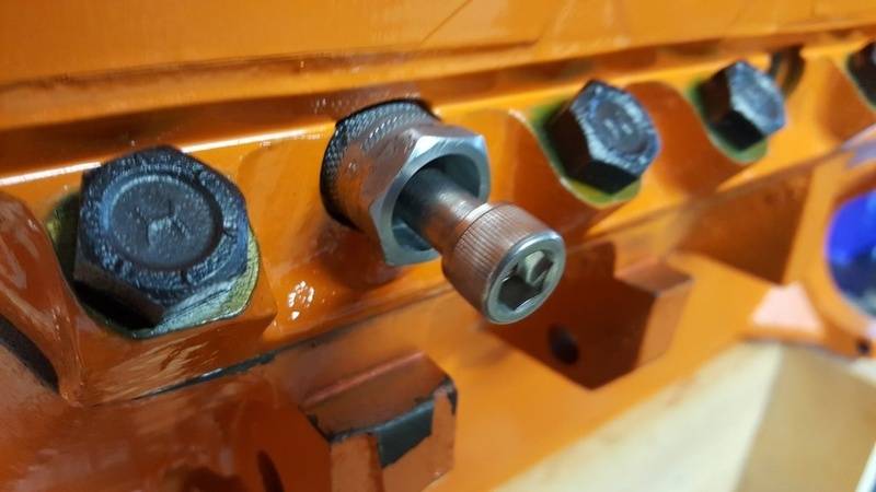

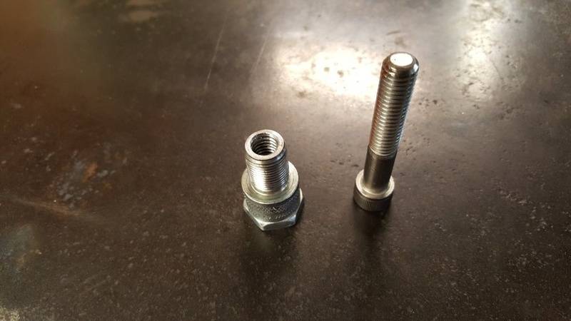

Just gonna buy a metric bolt that is same thread as spark plug. Bring piston close to tdc then thread it in to touch. Then hand crank backward to stop again and check. Should work.Make a piston stop out of an old spark plug. Knock out porcelain 1/4" bolt put thread end so it go in chamber and put a nut on tack weld it. Or loctite. Do Not use starter to turn engine, my disclaimer.![]()

I understand that you can have it perpendicular to the crank as long as you have the plugs on the cap where #1 is where rotor is pointing. My question was to find out if possibly my balancer or pointer were not correct. If my balancer or pointer are not in their correct place and I am using the zero marks on them for TDC to begin setting my distributor, then I may be too far advanced at my starting point or too far retarded. I did find TDC and thankfully it is where the 0 on balancer and the pointer line up. Then with distributor out of engine and cap on, draw a line on the distributor body where the #1 spark plug wire bulge is at. Remove cap and continue line up onto lip of distributor body. In my case, the slot in the intermediate shaft points just a hair towards the passenger side with the engine at true TDC. I bumped the engine around until it was coming back up on compression TDC then hand cranked it to 8 degrees on balancer and pointer. put distributor in and lined the rotor up with the line on the lip of the distributor body. This should put it at 8 degrees BTDC for initial start. Now that I have confirmed that the distributor is where it needs to be, I've got to remove all my spark plugs because they are all fouled now. The prime on the FI is extremely rich. I'm researching now how to program it way leaner for the prime. Apparently it has a range of 299% multiplier down to -100% multiplier and some people actually have to go all the way down to that. I'm going to reduce it quite a bit and see if I get anything. Hoping I don't have to remove all the plugs and wipe them all off.Glad it works for you. The point I wanted to make is that the position of the slot on the distributor intermediate shaft has NOTHING to do with an engine starting or running. O/P is trying to get the engine started and the slot position is irrelevant... Another thing I hear constantly is that the rotor has to point at #1 spark-plug when dropping the distributor into an engine. This is confusing to NEW mechanics. The rotor has to point to the #1 spark-plug WIRE TERMINAL in the distributor cap when the engine is on TDC compression stroke.
