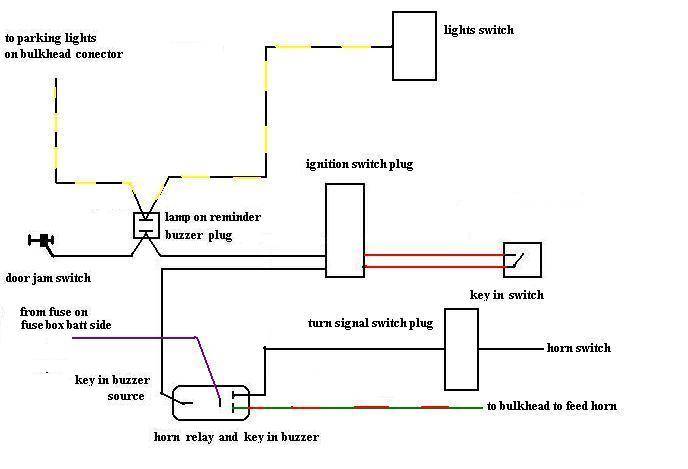

71/73 relays are 4 prongs relay but one of them is for the key in buzzer function. The other three prongs grouped together are the horn relay function itself... Positive on violet wire, Trigger ( ground coming from horn switch ) on black wire and output to horns ( positive ) on green with red tracer wire.
74s are 3 prongs, because key in buzzer was set in another system

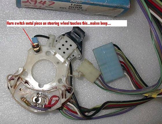

Either a loose connection inside the horn switch under your steering wheel....or a bad track on the contact ring for the horn switch.
Sounds like engine vibrations are travelling up the steering column and making this problem occur.

Ring can be replaced, yes ( if you find it ), but that wouldn't make chatter the horn. It can make contact or not, but that doesn't make to work the horn, just the switch or an accidental grounding around. The ring function is make able the contact on a rotation movement instead a wire turning around, but not close the circuit like the switch is

well i believe your right. took the steering wheel and extension off then grounded the contact wheel that rides on the contact ring with the engine running and the horn works. hurray. the column does have vibration. now what to do about. thank you fellas so much for all your imput. jd
