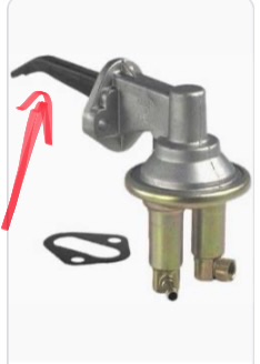

Thanks…fuel filter is new. By “push rod”, are you referring to this arm? I wouldn’t have thought about that part wearing out as it rides on an eccentric on the camshaft…If you are going to remove the fuel pump, check the legenth of the fuel pump push rod. They do wear out.. Also check fuel filter.

Big blocks run a short arm pump and a pushrod. Small block pumps have no pushrod.Thanks…fuel filter is new. By “push rod”, are you referring to this arm? I wouldn’t have thought about that part wearing out as it rides on an eccentric on the camshaft…
