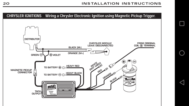

On the wiring, there is a very nice, detailed, wire schematic on the MSD website that shows how to hook their distributor to a Mopar ECU. It is a link off the page selling the distributor.
Here's what I got from MSD website
If its the MSD dist with the magnetic pickup then yes it will work on the Mopar ign. Even without a plug to plug it right in it will work if you cut and splice the right wires from the pick-up coil to the ECU box. Ron
