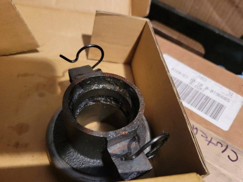

Isn't there a grease recess in the throwout bearing sleeve? It needs to be lubricated to slide back and forth on the trans bearing retainer.
Looking right now for someone Who can machine one,
I dont trust that QT bracket, I Also cant find replecement part, especially not here in Sweden
You could easily make one from a piece of angle iron with a saw, file, and drill.
I dont have no recess, check my earlier photo
Well, ' I don't have no ', check again, the cavity for grease is in there, it's in mine.

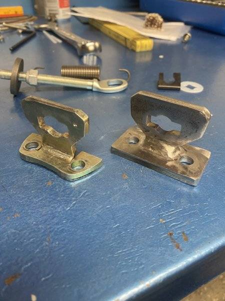

Got some help building this replacement part, (too the right)
Installed it and it seems to work fine, drove the car a couple Miles. Problem solved i guess!
Thanks for all input !
