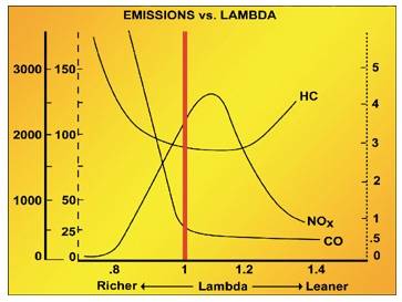

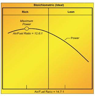

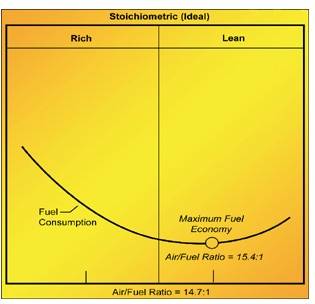

Lambda = AFR/14.7
so Lambda of 0.8 is simply 14.7*0.8=11.75.
WOT is different as you want it richer to help cool the valves and such 12.4 or so as KernDog says
Although the mid range is on the fringe of too lean, I like your numbers. During the conditions where it counts, your A/F ratio is rich enough. Under light/cruise conditions, you don't need a ratio above (numerically lower)14.7, slight lean compensates for other throttle conditions that require enrichment.
