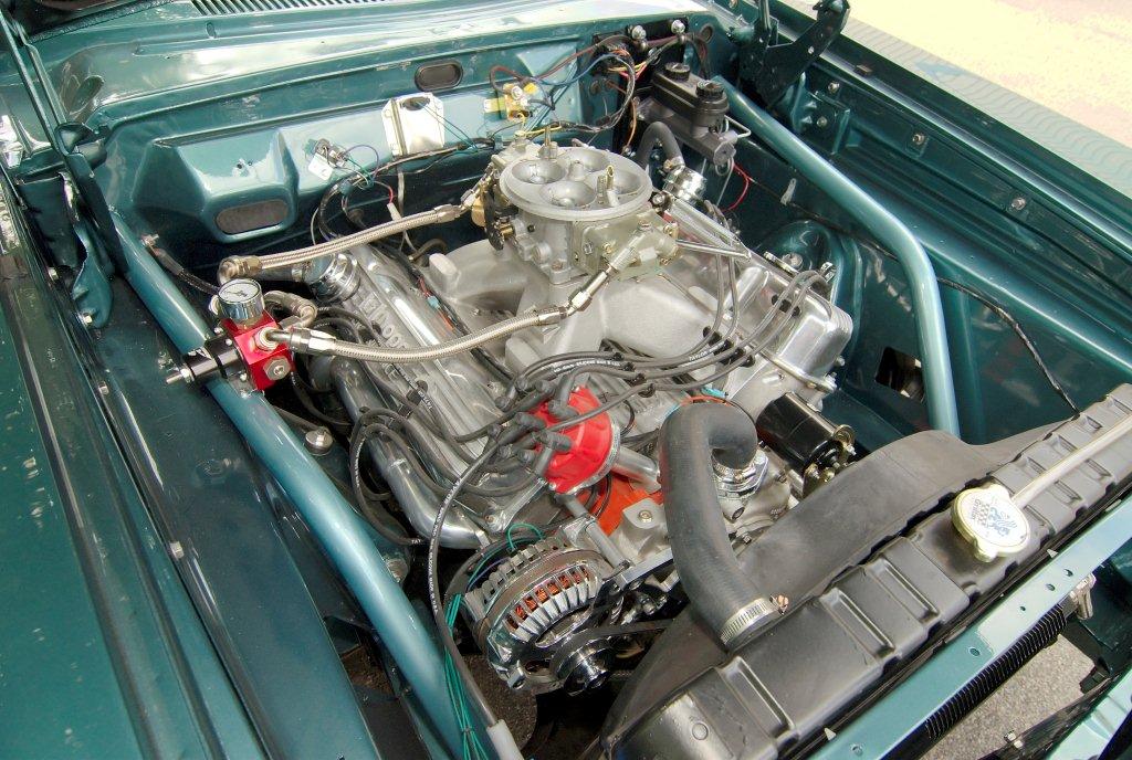

This is the A&A Transmission Cross Ram with Edelbrock Performer RPM heads on a 440 RB in my 65 B-Body. The carbs are Edelbrock 600 cfm with A&A repro air cleaners. I'm using Crane gold 1.6 to 1 roller rockers with stamped steel covers--NO ISSUES AT ALL. Do yourself a favor and get all the linkage and fittings from Rick--everything works as it should!!!

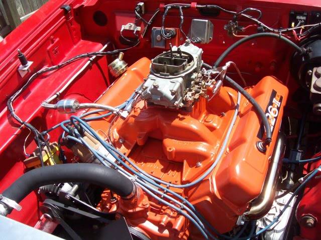

Sorry, didn't want to hijack the thread but I have a quick question:
What valve covers are those and are they taller than stock, stamped steel valve covers?
I'm going to try to run these stock covers with 440 Source rockers, which are roughly the same size as the Crane Gold. I was concerned about clearance issues.
