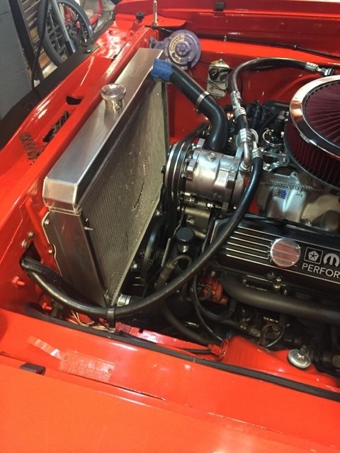

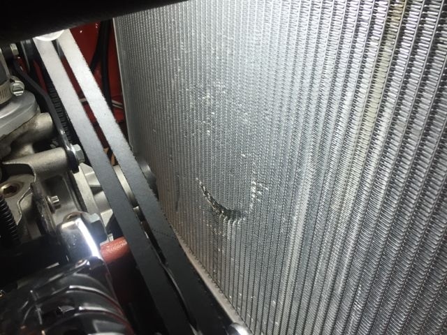

Then I pulled into the pits for the car to cool down. I returned a few minutes later to find a small puddle under the radiator. It took 'till I got home to figure out what had actually happened, but when I got the fan and shroud off, I was able to see the following:
I am running a Wizard aluminum radiator and shroud with an engine driven fan and a standard Mopar fan clutch (removed in the photo). At some point during my track day, I believe during the drag racing, the fan clutch and the radiator came together, closing the 5/16" gap between them and adding an additional 3/32" dent into the radiator. I say it that way because I'm going to ask YOU to tell me what actually happened. Did the engine move forward enough that the fan clutch hit the radiator? Or did the radiator and core support move? (Seems unlikely but someone here besides me is the drag expert).
The engine is "tilted back" in the car compared to the core support and the radiator, which explains why the fan clutch touched the radiator "at the bottom of the circle" instead of in an even circular pattern.

If you bolted the fan assembly back on, how close is it to the radiator?
Is the scar on the radiator the same height as the clutch or higher than the clutch?
How old are your mounts?

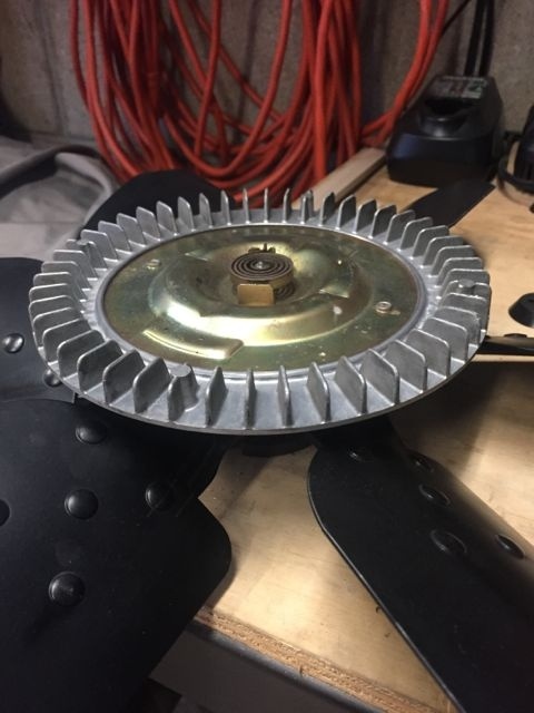

The engine mounts are Mighty Mounts and were installed with the engine about 1,500 miles ago. They should be good, or as good as new anyway. The distance from the clutch, at it's lower edge (which is closer than at the upper edge), is about 5/16" from the radiator, and the scar is definitely from that - from the cooling fins on the clutch hitting the radiator.
That 5/16" was there both before and after the two came together, in other words, the engine moved, hit the radiator, and moved back to its original position. I was actually able to drive the car with no problem after the crunch, it just leaked a little.

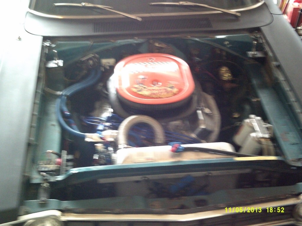

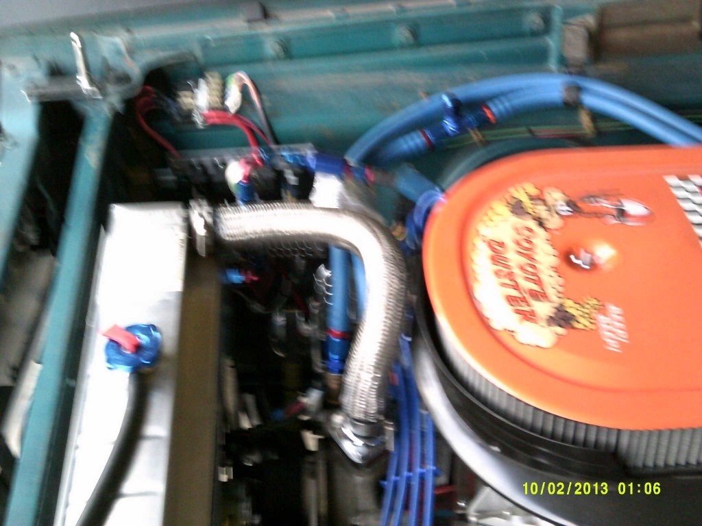

I like to be on the safe side, I have an Pro-Comp electric wp 37gpm
has a constant gpm flow not up & down like a mechanical pump is,
constant air flow from the electric fan too, not up & down
like a mechanical or clutch fan...
& 2 elec. fans 1 Perma-cool #19115 2950cfm 16" alum. blade
& 1 Perma-cool #19113 2650cfm 13" alum. blade pusher just in case, for in traffic etc.
both fans are reversible too, if need be to change puller to pusher etc.
{all ran thru each on a 30-amp Bosh relays & separate arming switches}
with a 4 core Mancini down flow 22" alum. radiator &
also a custom shroud for the inside puller fan...
No thermostat just a 3/4" hole washer in place for restriction
to keep water in the rad. a bit longer, I've ran this set up a couple times now...
I live in Calif. it's been driven in 95*-100* {traffic} serious heat, no issues of overheating,
180*-190* all day long {knock on wood} BUT; if it shows signs it may climb,
I do worry some then, especially when your beating on them...
I'll turn on the pusher fan, it drops temps almost instantly...
my 383/479ci engine makes about ballpark 600hp & about 600ft/tq
Perma-Cool Electric fan 16in. alum. 2950cfm prm-19115 $157.31 Summit.jpg Perma-Cool Electric fan 13 in. alum. in 3000cfm prm-19113 $153.05 Summit.jpg
Don't believe all the naysayers, it revs far quicker far more responsive,
make more power not turning the water pump & fan either, another free
{well kind of} another 12-15hp, not running the belt, mec. pump & fan....
It works well for me, You success/results may vary...
good luck what ever you decide
sorry the dirty engine comp. & crappy photos,
it's ment to drive, not just look perty... 68 RR #24 Apr 21 2011 479ci-6bbl.JPG 68 RR #25 479ci-6bbl Front of engine bay.JPG 68 RR #26 479ci-6bbl Dec. 2013.JPG

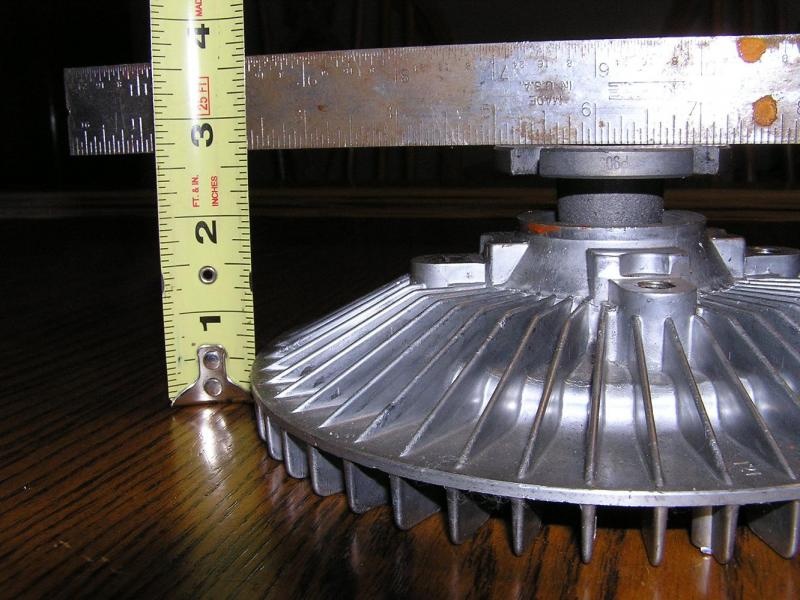

2-11/16" is the Hayden 2765 clearance? How does this compare to your current fan clutch?
The car is a 727 automatic. The fan clutch I had been using is about 3 1/8", so it looks like I could save 3/8" to 7/16" or so just by switching fan clutches. That's a lot.
