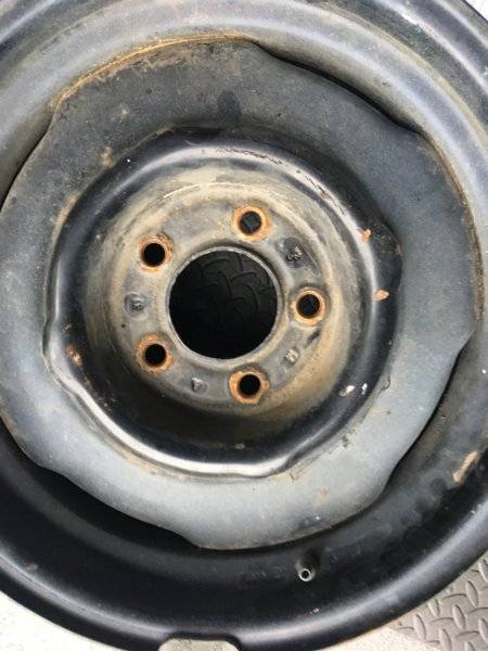

Bought two 15 inch steel wheels at the swap meet for a spare in my trunk and was curious what I bought .
Not thinking I bought special wheels just want the info on them for my own knowledge .
The foots mine -bought and paid for lol .
Markings on the wheels as follows -RIM 1
front face K2 , N , 8 , W - in rim area RM , pentastar , Kelsey CA NA DA
RIM 2
front face M , W , K2 A , Rim area Kelsey Canada S1,3 ,K2 -N15X55JJ
Thanks Pete
RIM 2
Thanks Pete

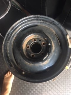

The Only Problem I see is it looks like there's a Foot Attached to it ?
Funny as soon as I was about to post that I thought I should retake that because someone will notice the foot ..

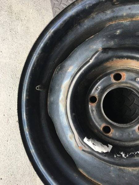

The rim pictured is a Kelsey Hayes.....Is that rim 2....If so then the K2 is for 72......
A better picture clearly showing those markings and the valve stem markings would make it easier to clarify....

Thanks Justin , I'll get a couple of better pictures .
Here are two hopefully better pictures .
Wheel one has the sticker on bolt mount area
N ,3 8,k2 - on either side of valve 8 ,3
Inside rim - hidden by tire
DO , pentastar ,Kelsey Canada
RIM 2
Bolt mount area
K2 with a 5 under ,3 , 31 , A
Inside rim
55JJ , 15x55JJ , Kelsey Canada , 2,51
On either side of valve K2 5 ,3
Thanks Pete

Rim 2
1972 May 3rd
Rim 1
1972 August 3rd
