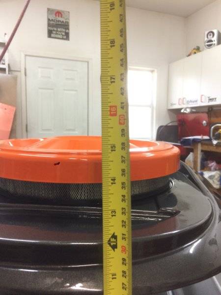

FWIW here's a frontal view of the motor with Indy intake, mockup carb and '70 air cleaner. Total height is 15" measured from the front pad on the block. That's a 383 baseplate and a 440 block but using a 440 baseplate wouldn't make much difference.

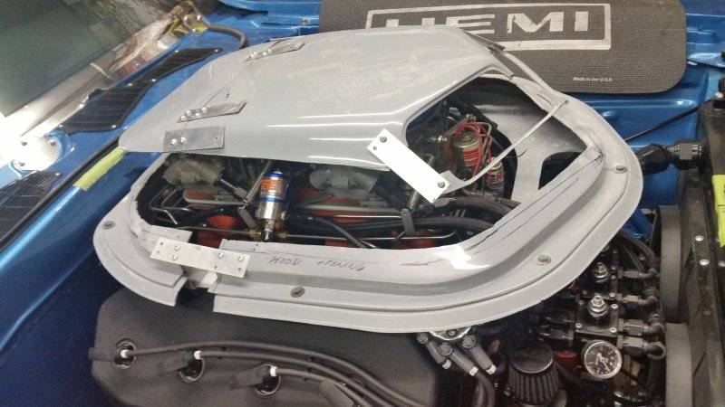

I also made my own custom hood opening, base and bubble shaker to fit my tunnel ram and two 1050 Dominator carbs on my 70' Challenger.

I like that shaker fix :) Unfortunately the air grabber doesn't have a vertical degree of freedom like that. I'd like to use the torker and 850cfm holley I have.

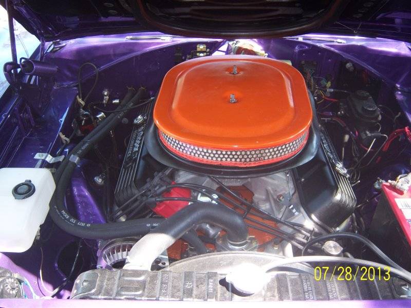

It can be done I run a Holley Street Avenger intake with Proform 850DP carb. 69 GTX with factory air grabber 440 block.
On my car I have a custom fiberglass base that lowers the carb and air cleaner just enough to get the stock hood to close.

Did you buy that base plate to fit, or buy and modify it yourself? How much lower did the base have to go to make it work?

I bought the base plate from a gentlemen in Texas. I don't remember his name. He posts on Moparts site. He makes custom base plates. I had to modify the one he sent me. I needed to remove about 3/4 inch of material from carb mount area. I think it was designed for a B engine.
