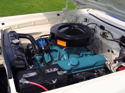

It's not the exact same thing, but maybe this idea helps you. I used a K&N 14"" drop base along with the factory lid. It gave me the extra 1" - 1.5" clearance I needed.
The picture doesn't give the best detail but you can see how low the air cleaner sits on my Edelbrock carb.
I thought of doing what you describe too but a 1" tall element might choke your big block a bit.
