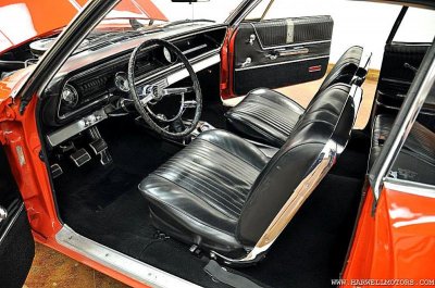

65_impala_ss_427_4_speed_3.jpgI have been thinking about getting 1965 Chevy Impala buckets. My Impala had them and they were great looking and very comfy. The trim is nicer looking than the 67 Coronet ones.

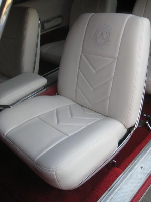

here is a pic of the custom seats in my 66 Charger I had made. I bought the legendary foam and the shop added some bolstering. I had all seats embroidered and the shop made my design come to life. Any good upholstery shop should be able to do just about anything you want.

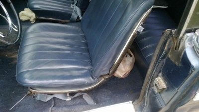

1967 Chevelle Buckets

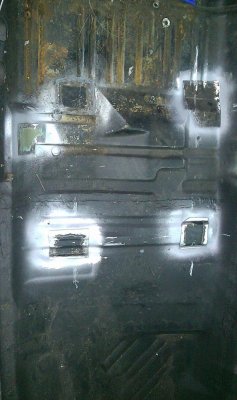

IMAG0571.jpgThese cane with the car, comfortable and no bolster. When I replaced floor pans doubler plates were put in place. Seat parts are reasonably priced.

I drove from South Carolina to Seattle and back in my 65 Impala SS 454 auto. The seats were very comfortable. The wide chrome trim around the back is a standout for me, it just looks great in a clean interior.

Wow, Kellycom, those look really nice. That embroidery is impressive.

Thanks ODZKing.
I need to replace all the arm rests. Your eagle eye spotted the passenger rear and as luck would have it. The driver's front is ripped in spots. I have new seat front seat belts coming for it. The interior is a work in progress. But not much left to do.

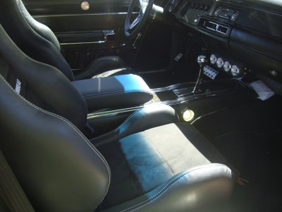

I've got the GTS II in leather with suede centers in my 69 charger. They look and feel great! Installed perfectly with no mods.
