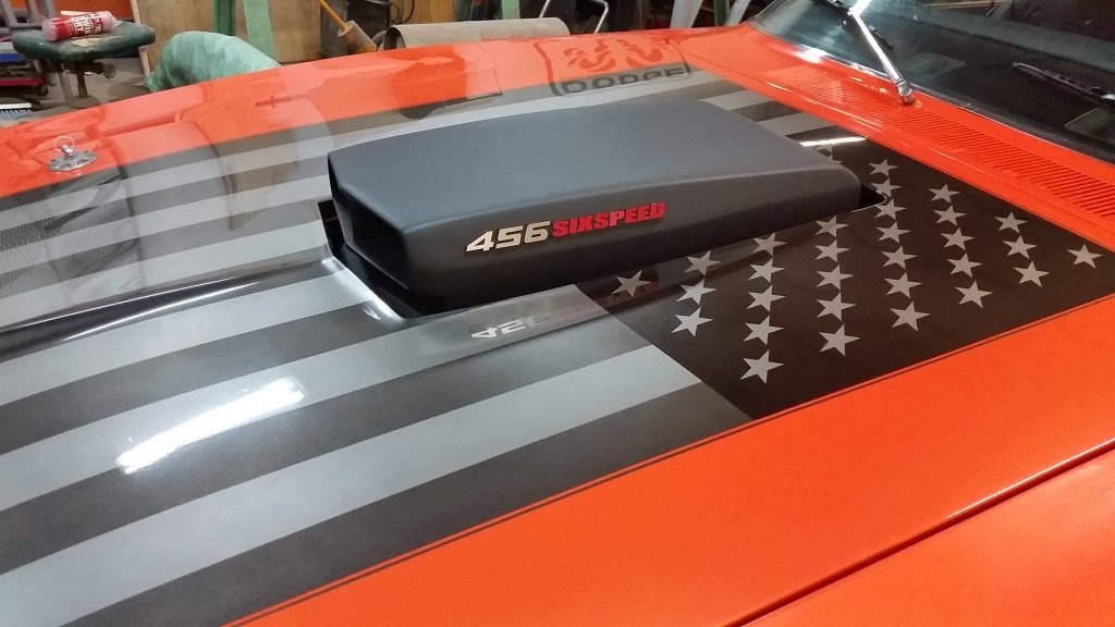

I only show this pic to encourage people to learn fiberglass and show what you can do with minimal tools. After receiving a lot heat for contemplating using a Mach scoop I made this one out of fiberglass. It's a true shaker with a dual quad oval cleaner inside with one quad sealed shut (wanted a lot of filter surface).
For something like this where it will be subject to the elements you simply make a form out of wood, foam, or anything else you want then put 4-6 layers of glass on it, let it set then pull off form and finish it up. Smoothing it is a breaze seeing how it's glass you just fill the lows with fiberstrand (basically the same thing it's made of) then a touch of traditional filler, prime and paint.
