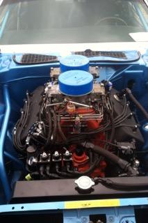

Glen Ray radiator. The owner has one of his 3 core 26 inch radiators cooling his 572 wedge motor.

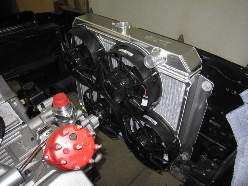

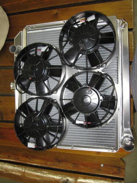

My Wizard is beautiful. It was designed to cool a 540 wedge. 22" wide.

Why do you have 4 electric fans? I only have 1 16inch fan and so far I haven't needed to turn it on.
They are going to be staged in pairs. I have to cool 765 horses with that narrow 22" width and I have A/C. Wizard designed the capacity.
