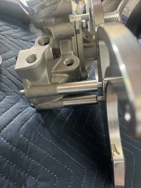

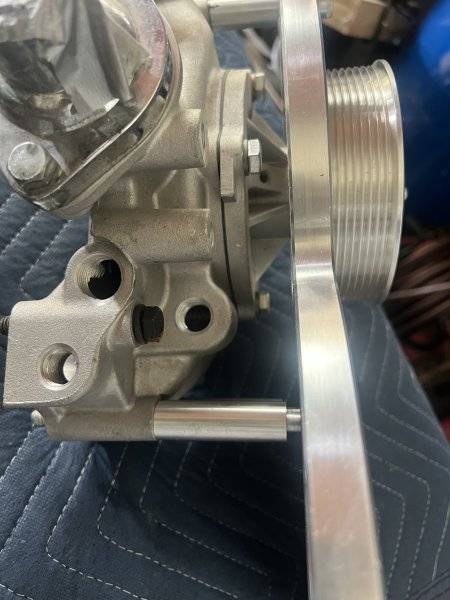

Purchased the Wrath Serpentine Kit from CVF bolted it up to find out they put the mounting bolts where the heater hose Screws in. They wanted $200 to send me another mounting plate. For almost $2k you would think they’d correct their mistake at no charge had my buddy relocate the mounting bolt. By the way he can reproduce any CNC’d parts
Looks good, now :thumbsup:
pour customer service to want more money ($200)
for them sending the wrong part

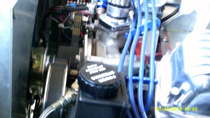

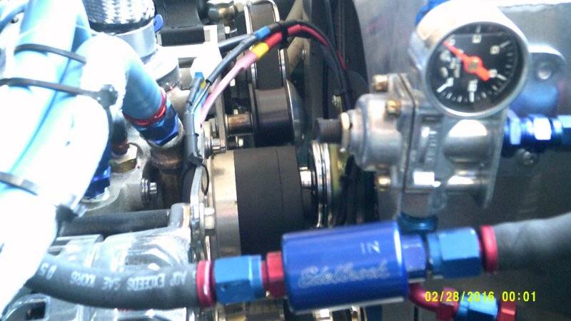

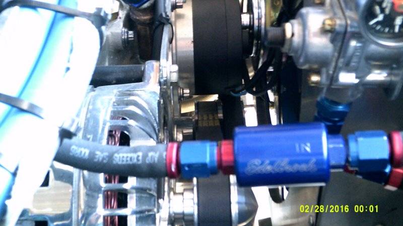

I have serpentine belts on my 68 RR too
2 separate belts one for the alt. & 1 for my rack & pinion power steering
pulleys for the alt. & the crank pulley, alum from March Industries for about $150
(? it was a while back can't remember) the power steering pump for
Unisteer rack, had it already
nothing goes over the water-pump, I do have an idler
& it's electric pump 35gph & runs cool 180*, a MRE large tube 22" alum rad. 19lb cap
2) 3,000cfm alum. blade fans, like 10 amp draw,
1) 13" pusher & 1) 16" puller in a custom shroud
have it all on 2) Bosche 40 amp relays & arming switch (Painless) inside
going on 15+ years now
I don't have even near $1,000 in to the whole damn thing,
belts pump pulleys idler rad. cap switches
sorry I'd post my photos but you can't tell much it's pretty tight
thicker rad, rubber mounted, took up anther 1/4" didn't help,
but it all fit well
didn't spend anywhere near the $$$, some do to do the exact same thing

What did the destructions say about it.
Water pump looks to be upside down
yeah could’ve used a bunch of fittings to make it work but I wanted a cleaner looking install
