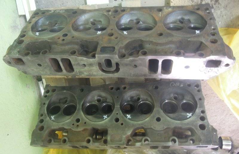

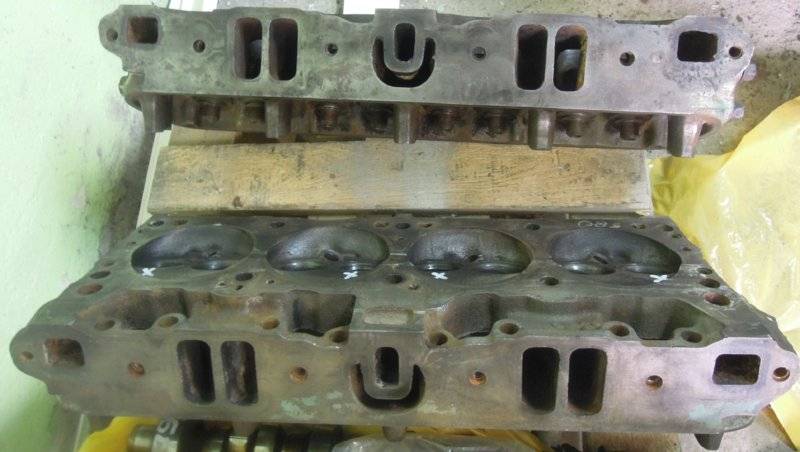

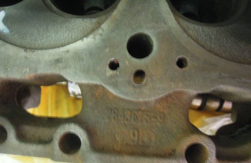

1.Cylinder head are exchangable? means left fits on the right and vice versa ? I have this question because if I looked on the parts shop i see description "fits right or left"

I'm assuming that you're comfortable with doing this kind of work and want to "freshen" the engine rather than rebuild it completely. If this is the case you can purchase what you want by just knowing the engine size and year. Some engines have specifics so you will want to look up the engine serial number and verify if it is special in any way. Once you have this information you can purchase a new crank, crank and rod bearings and the proper heads weather you're going iron or aluminum. When you order what you need, make sure the supplier knows exactly what series the engine is. I've never encountered heads that fit either side but then I've never had a 318. Be leery of this claim and deal only with reputable supply shops.

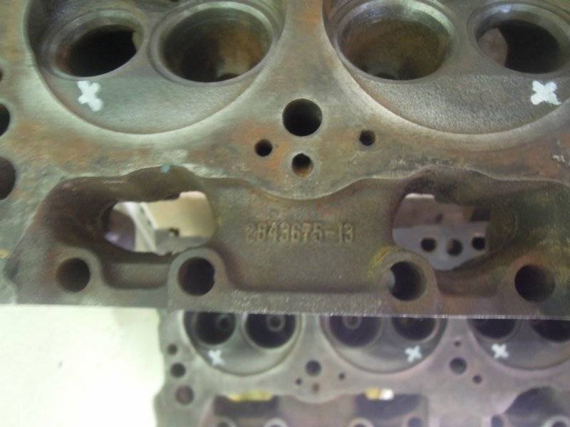

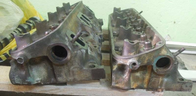

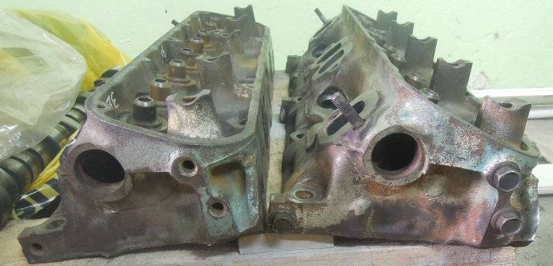

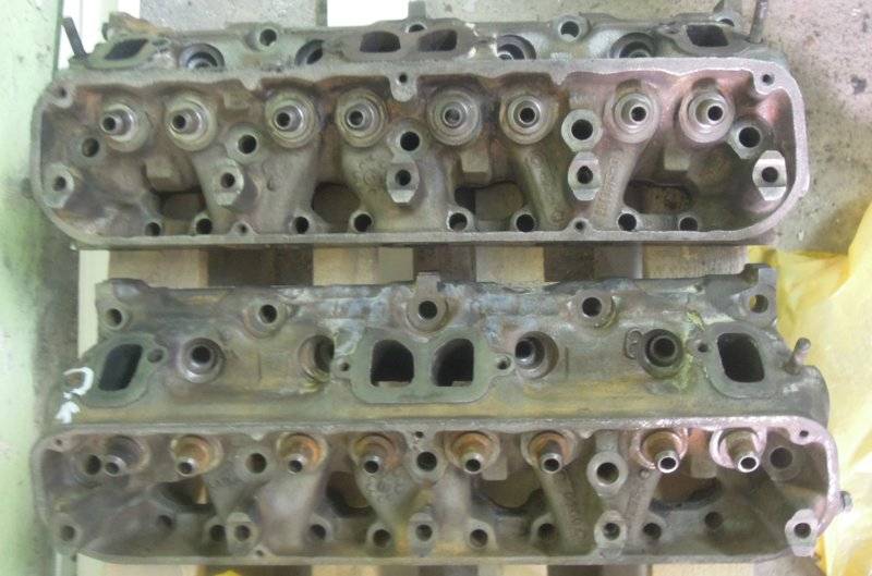

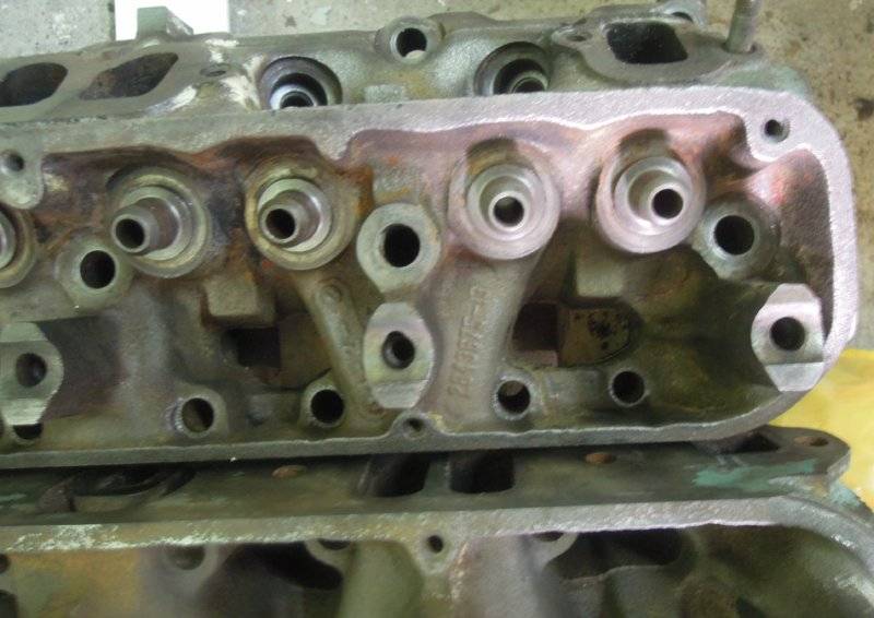

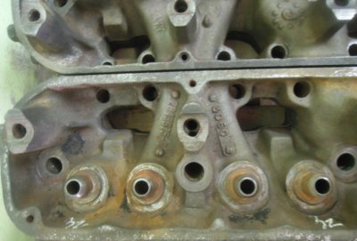

I checked heads numbers , left have this same number as right.I checked physically both heads and they looks as this same.Please look below at the photo.
