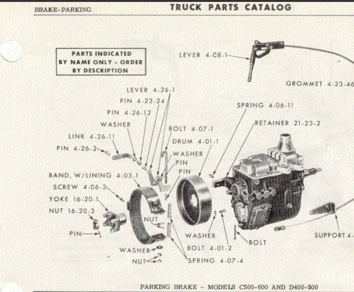

Here's what you're looking at:
Not sure why it's on a D100 model. But maybe a HD trans was installed from a D400.
And I'm betting that trans has the granny low 1st gear. Had a 1 ton pickup in the 80's that had a similar looking trans (forget the number of it) but it didn't have the park/emergency brake on the drive line.
It's a NP435 variant (granny 1st) with brackets added to support the parking brake mechanism. I've seen them once in a while, but Uber rare. Usually they are on HD trucks, and also try to find one on a W series as they are transfer case mounted.
