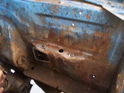

I figured the firewall was going to be a pain figured I'd do my best with a drill n coned wire wheel

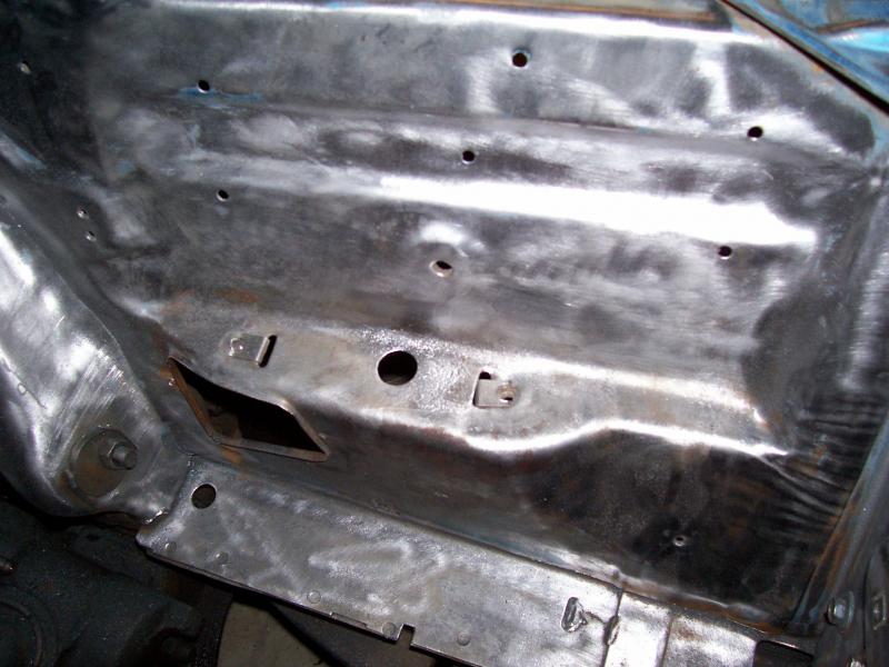

Nothing against Donny, I would have loved to have him come out ot SoCal and do my car. At the time i was looking into blasting I couldn't find anybody that offered his level of service at his prices. But the drill and coned wire wheel method works ok. This after pic isn't a completed pic. I put some more work into it before i sprayed it with a rust inhibitor, then primer/sealer, then paint.
That came out pretty well. I'm nervous to pull all that stuff out of the firewall. not super experienced with that stuff.

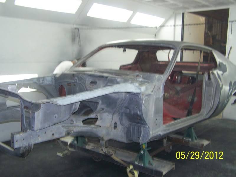

I agree with Donny as far as getting it "all" and blasting leaves a perfect surface for a good epoxy bond. What I did may be a good option for you, I don't have an expert blaster like Donny around here so I stripped the car of all panels, fasteners and the quarters were off as well then hauled it in for sandblasting where I told him to not touch the roof (no warp prone metal was touched). Then I stripped all of the panels with a stripper (you could just DA them) finishing it with a DA. The doors, fenders, hood and trunk lid usually only have rust at the bottoms or edges making them a pretty easy clean up with a small blaster. I paid the blaster about $350.00 and believe it or not he did a really good job. I really think you should at least buy a small hand held blaster to at least blast the rusty areas so it will get all of the pits cleaned out "I love freshly blasted metal".

How strange, I thought it was you Coronet340 that called, but, it was a fellow in Memphis TN inquiring about getting his 70 Coronet blasted. I was flattered that he would think about bringing his car way down to me!
That shows quality of work.
