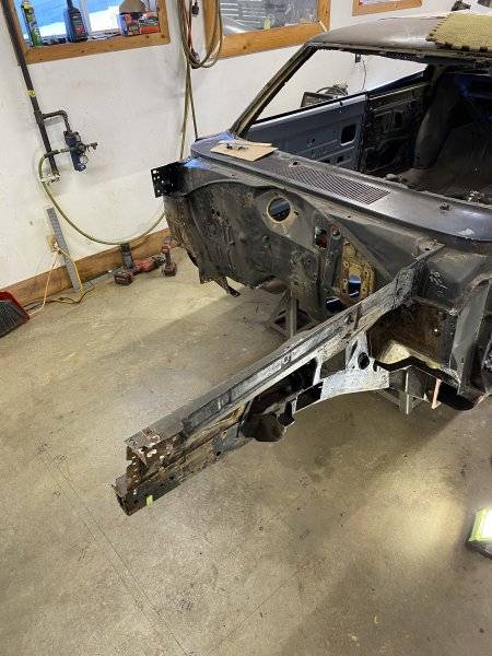

Started taking the front apart today. Using a laser I leveled the car to the datum. Got the doors where I like them. Also dot lined a bunch of measurements to the floor.
I’m still not sure if I’m going to tackle both frame rails at the same time. I’m thinking I’m going to start on one side, bolt the k-frame in and mock the fenders and hood up just to see if I’m close.
I’m going to try and save the lower radiator support and shock towers.
No turning back now! I’ll start mocking up the passenger side to see how things fit before starting the drivers side.
that's how I'd do it....... bolt the K to the existing rail, to locate the new rail.......then the other side
provided it was never hit in the front; which might change things
mock all the front metal including the front valence, it helps flex the fenders into shape...... the gaps change if the fenders are just hanging there

Sounds good! Thanks for the advice. I’m going to need every bit of it. It was hit in the front so nothing is a given on this one. The passenger side took the hit. Hopefully it didn’t transfer much to the drivers side or the K- member. It X out ok with a tram from what I could tell.

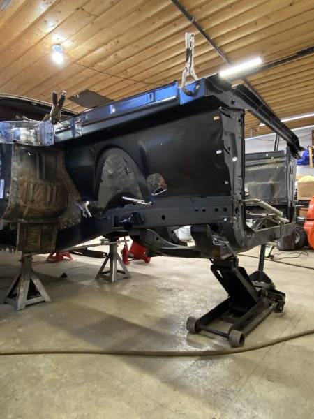

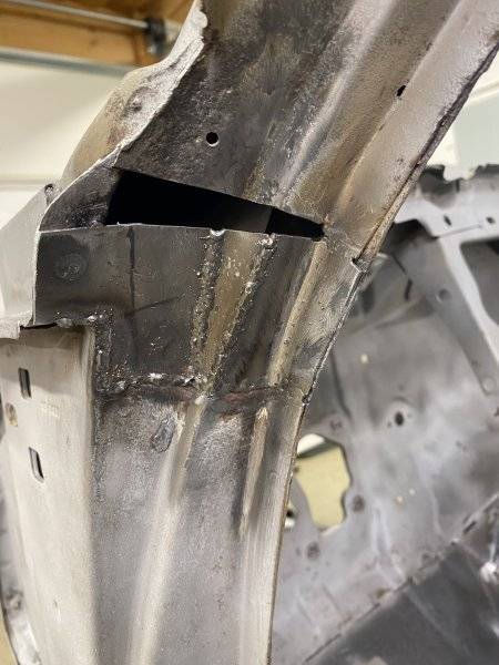

Starting to come together! I had to burn a patch in the torsion support. The AMD stuff fits nicely. You have to cut and modify to get a good fit. And you can never have enough vice grips doing this stuff! I’ll fit the hood, fenders, valance, and whatever I can to make sure it’s right.
I’m happy with the way I have the front fitted! Everything is AMD so it doesn’t really drop in place. The body guys that do this every day must be ridiculously patient or maybe they actually know what they are doing. I’m ready to start taking the drivers side apron and rail out mock it up again and weld everything up.
Ready to weld everything up! A pretty time consuming project but happy with the way it came out. Next onto sandblasting, epoxy, then getting it back on some wheels!

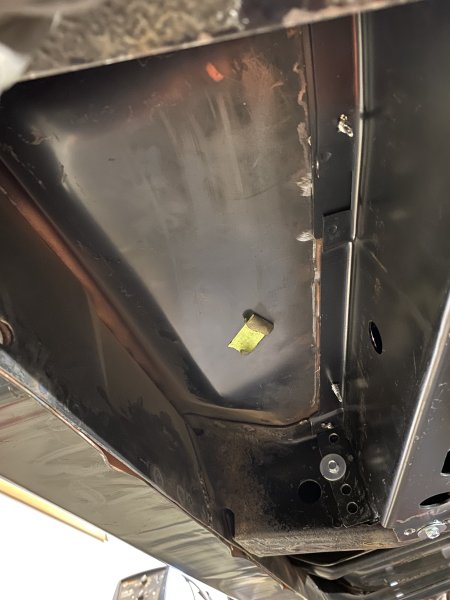

Finally got some time to mess with the car again! Nice weather is back around so work has gotten busy. It’s funny how tiny rust holes turn into big ones once you dig into them.
I pushed the car outside and blasted what didn’t get replaced. I’ll need to do some repairs here and there!
