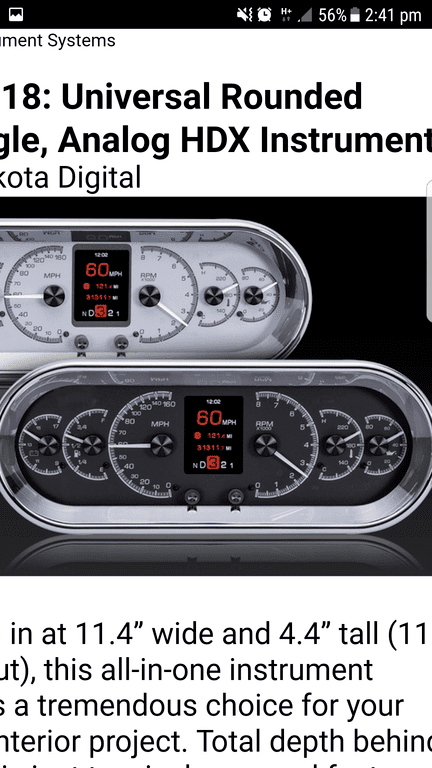

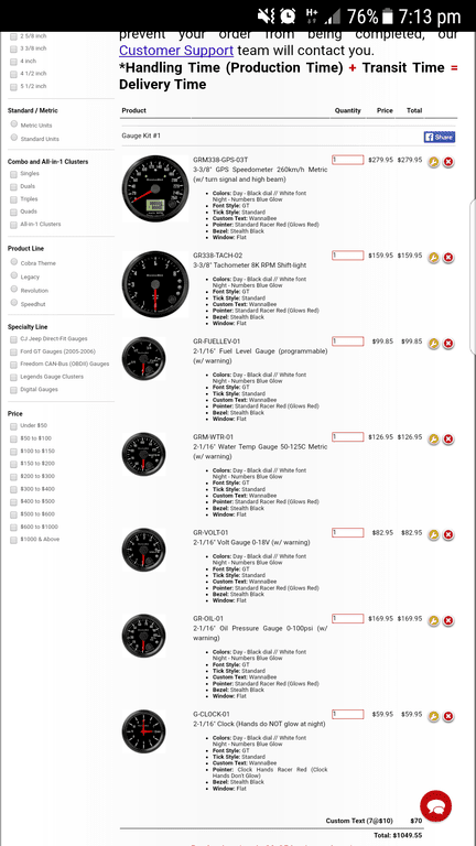

Hi im tossing up whether to buy a Dakota Digital gauge cluster or Speedhut gauges. Visually i like both and both are very different. The Dakota has a few more options/ add ons but the speedhut is GPS. Has anyone had experience with both or either one. The prices are very similar

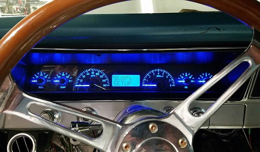

I've installed the VHX's in my my father in laws 67 Nova and loved the ease and quality. The only thing I didn't like are the programming buttons are separate from the cluster and have to be remotely mounted and connected to the ecu. Programming & calibration is pretty easy.
I'm installing a set in a 57 TBird as we speak.

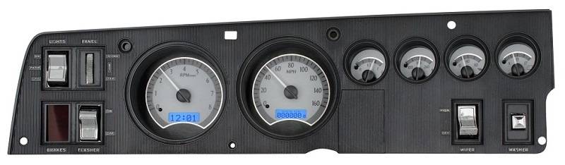

My brother put DD in the 70 Charger he built, he really liked them. Sorry I don't have a pic.

Oh really. Thats very interesting. I didnt know that. Im looking at thr HDX wo ive emailed them about it. Hopefully they do. Leaning towards the Dakota i reckon. Cheers.
Speedhut has a lot of different gauges, and they have both GPS and non-GPS speedometers. They also allow for a ton of customization of the gauge face, bezel, font, etc.
