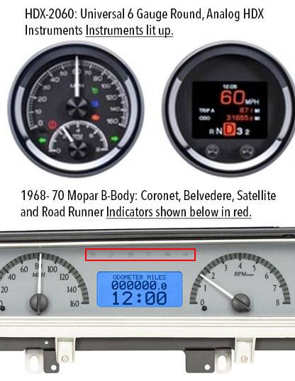

where are on these the turning signals, high beams and emergency brake pilot lights ? LCD screen ?
See picture, hope you can make it out... if not let me know i'll try to get larger more clear images.
