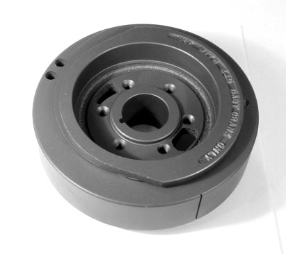

I was wondering about the line cut into the damper shown below. What does it represent? I'm trying to find timing marks on my damper and that's the only mark I see.
That's the pic I used, but the description doesn't say what the mark is for.
Just a guess... If the keyway is positioned at roughly 2 o'clock, which would be close to TDC and the timing tab off to the left, then the line should line up at 0deg on your tab.
It represents the TDC mark to line up on the timing tab on the timing cover.
So with the line and 0 deg mark on the tab lined up, the rotor should be pointing at the number one cylinder of the distributor cap regardless of which one is marked 1 on the cap itself?

Okay. The mark, or slot, on the dampner is the timing mark, that matches with the timing tab on the timing chain cover.
With spark plugs out, to make it easy to rotate the motor by hand, a socket or wrench on the crank/dampner bolt. Turn the motor until the timing mark on the dampner is in line with 0 on the timing tab.
That puts #1 at TDC...but compression, or exhaust stroke? Using a flashlight, look in the distributor 'hole' in the block. You should be able to see both #1 tappets, on the driver side of the motor. Using the wrench, move the crank back and forth a little, watching those two tappets. No movement...compression stroke. Little movement from both...exhaust stroke. If it's on exhaust stroke, rotate the crank/dampner one full turn, and look again. That will put #1 on compression stroke.
Once the motor is at #1 TDC Compression Stroke, then turn the motor in REVERSE, getting the dampner mark past the timing tab. That will take out the chain slack, when you go to the right rotation. In that right rotation, bring the timing mark to...the firing timing...5,10, or whatever you want. Understand the firing mark is Before TDC, in those degrees.
Now, your ready to install the dizzy. Normally the rotor kinda points toward #1 cylinder, with the advance in a clear area, for rotating the dizzy housing for timing.
Whatever kind of dizzy you have, look at the rotor/breaker, and set the dizzy in so the rotor is just coming, in it's rotation, just to the breaker. Distributor in, where the rotor is pointing, is where #1 plug wire needs to go.
