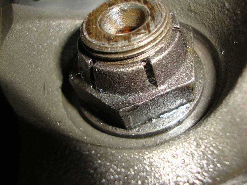

This is the factory line installed pinion nut.......No one manufacturers these and they are very hard to find. As you can see they are not a one time use nut.....
