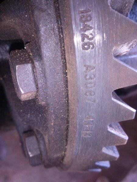

here's my 68 Dana and honestly I don't know what this numbers mean
Is this the original ring gear?
Yes, untouched and unmolested dana 60, my guess are that even the oil was the original, came out black althoug no metal in the oil and no sharp edges in the cogs still like new inside.
You numbers guys, I always thought that the end numbers 43-13 were 43 teeth on the ring gear and the 13 was the number of teeth on the pinion gear. That figures to a 3:31 ratio. Untouched Dana's were 3:54's or 4:10's for Chrysler B body's. I'm not sure on trucks. Let us know out there.
I don't have a pic but a small plate was in one of the studs and that was the number, 3:31and am sure is an unmolested dana and original to the car
You said 68 Dana, did it come out of a B body Mopar?
The only ratio that was supposed to be available in 68 B bodies was a 3:54. A factory mistake? or a gear swap?
Look at his bolt pattern on the rear end. Looks like 11 holes not 10. Dana 60 ???
This rear end appears to me to be out of a Ford truck or van originally. Not sure grip either.
I am sure it came out of factory like this, my car was build in Mexico, the car belong to a lady for 45 years, no way she drag race the car or change it but is a Dana am sure just I can't find the pic where it says dana in the gear ring.
I'm sure there were differences in Mexican built cars and nothing is impossible with Chrysler. Just one of those things! You have what you have and if you like it, keep it.
