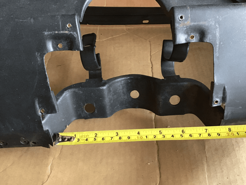

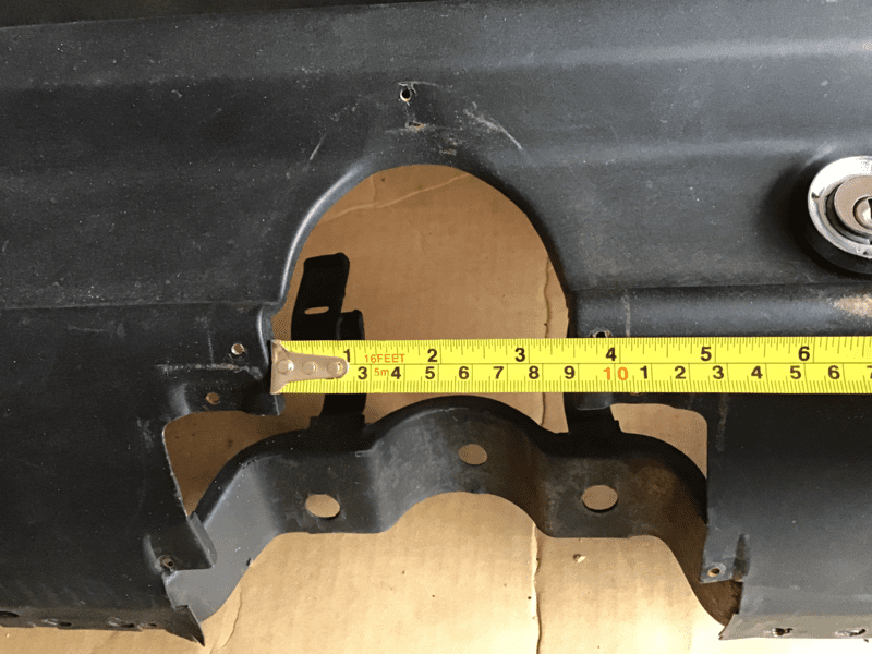

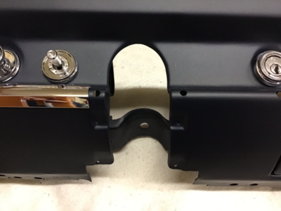

I though I would tell folks the difference between these dash frames, they are usually advertised as 1966-67 but they don’t interchange. Kinda long so just view the photos if you are in a hurry!
the column diameter is larger in 1967 because of the collapsible column, so the half round cut out in the dash is a different size. 3 1/2” wide on 1967, 2 3/8” wide 1966.

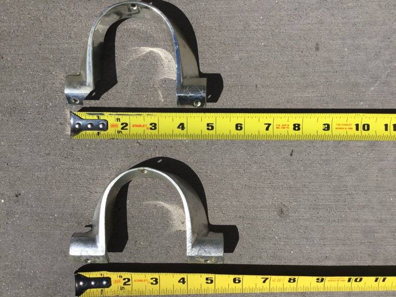

The chrome trim around that opening is different also. It is plastic and mounts with 3 small screws on a 1967. Use a #1 Phillips tip. #2 won’t work vey well.

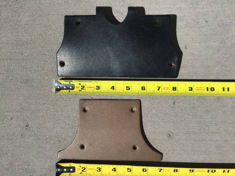

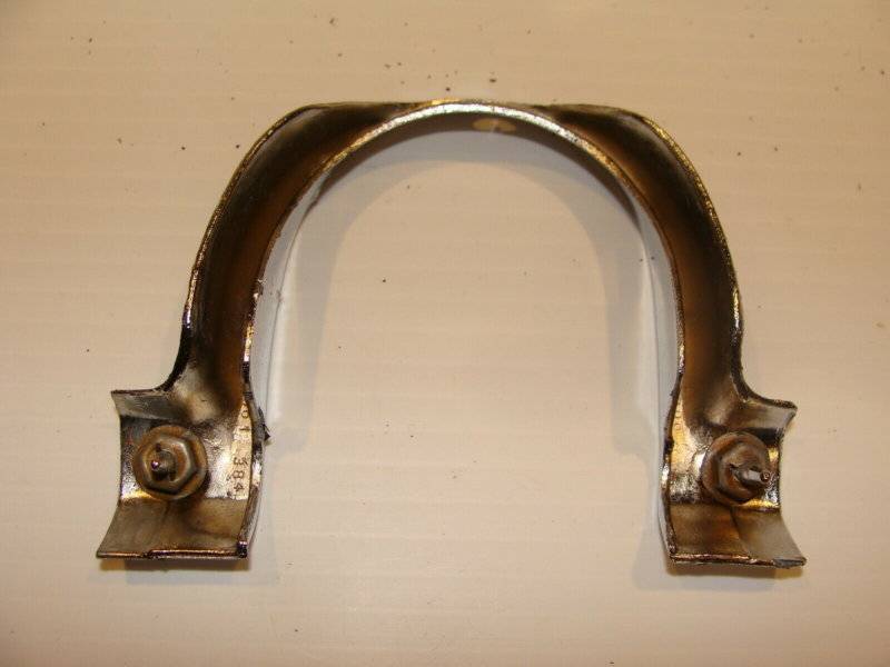

For a 1966 It is pot metal with 2 studs and nuts on and one screw on top. You will see the 2 large holes for the studs in 1966 dash are absent in 1967. The cover that goes over the column is larger and plastic on a 1967 and smaller and metal on a 1966
The brake warning light was standard and next to the flasher switch in 1967. The brake warning light was optional and under the dash in 1966.
1966 dash on top 2 photos
1967 dash on bottom 2 photos

Top pic. Is a 1966 pot metal column trim with the studs.
Second pic Here is the column covers plastic 1967 top and metal 1966 bottom, night and day difference.

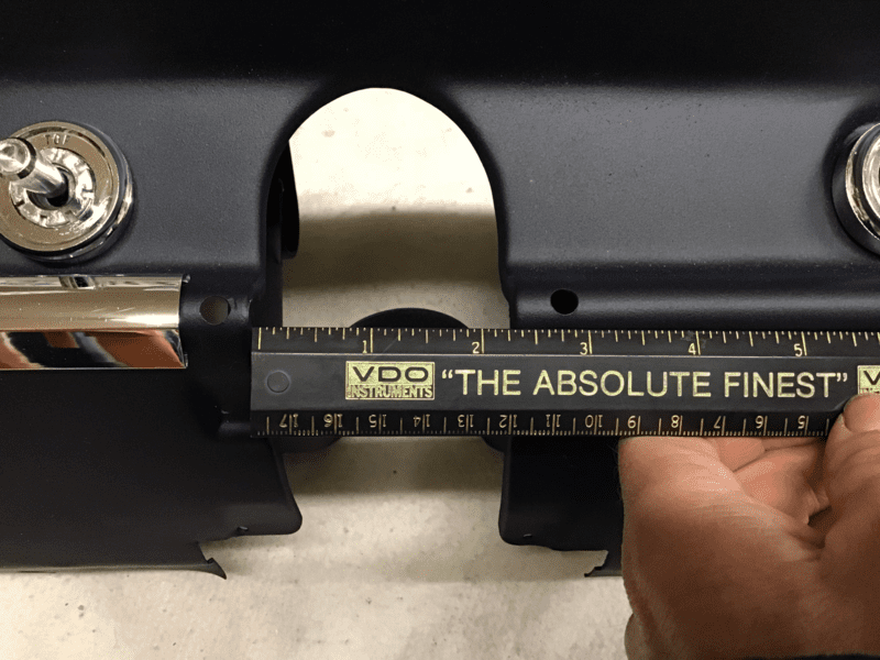

Third pic. Now further info on the 1967 column opening trim. There are 2 different ones. 2 door hardtop and convertible both have the chrome the runs along lower edge of the dash so the plastic chrome trim has longer ends that makes the piece 5/8” wider. So the plastic trim is different for all sedans with no chrome on the lower dash edge.
Some guys know this info, most folks do not. Now you do. Just check eBay and see the misinformation in the auctions.
Now we know the difference between a Coronet dash and a Belvedere dash, right? Coronet has radio up high in the plastic bezel and the plastic instrument bezel meets the glove box door. Also solid metal across bottom where Plymouth radio goes. Plymouth has solid metal in the center of dash between cluster and glove box door.
