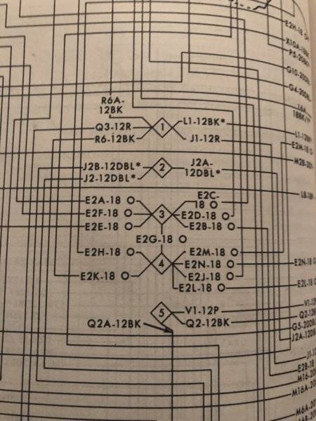

So i just reinstalled my Rallye cluster and now I have no dash lights. They flickered for a second, but now i don’t see any light. I checked the power going to them and they don’t seem to be getting any. I’m looking in my manual but i can’t seem to find where their power source traces back to.

Technically the dash lights do not “take power from the parking lights circuit”. The B2 power feed (circuits L8-18P, M5-18P, X1-16R) to the headlight switch is fuse protected by a 20 amp fuse labeled “Cig Lighter”, this unswitched fused circuit also powers the cigar lighter and the red unswitched three-way bullet connector tap in the dash harness, as well as the parking lights. Should this fuse be blown, all the above items, the parking lights, and the dash lights will be out.
