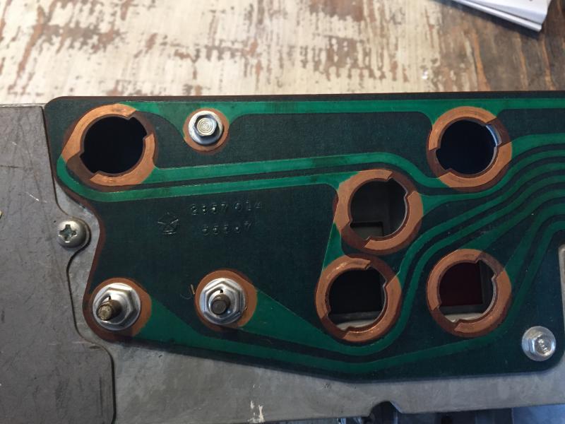

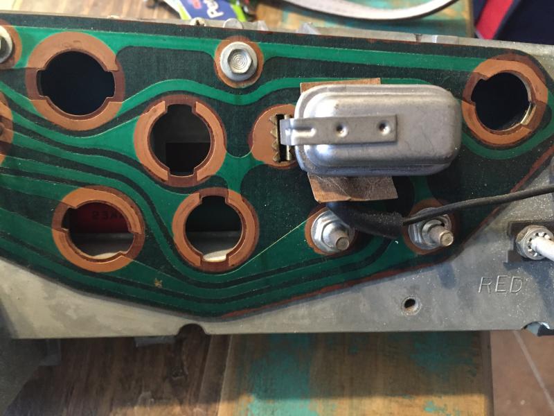

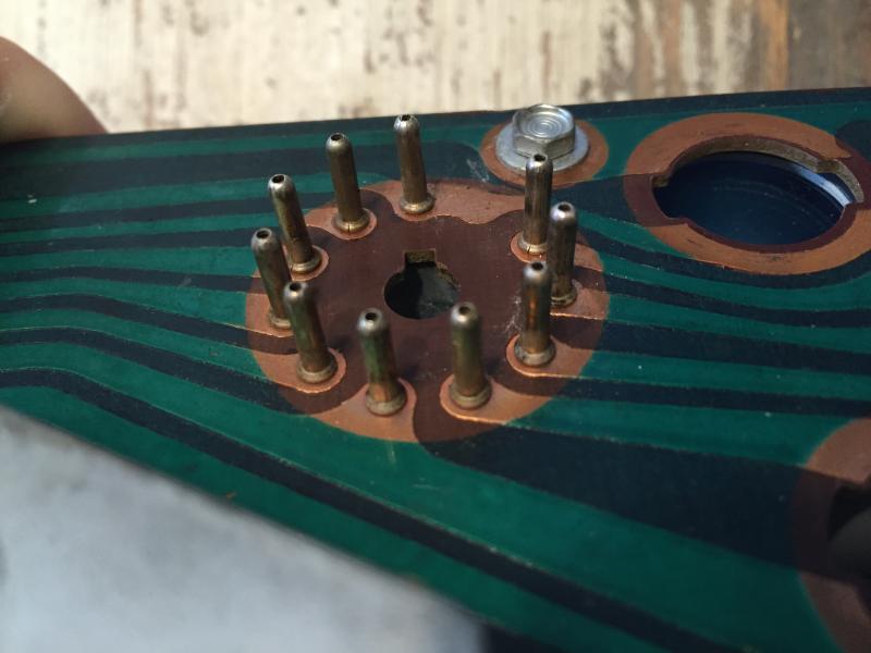

Ok thanks for all the tips. I've replaced the fuse and the dimmer switch. The only bulbs that work are the 158. I tested the orange wire on the main plug and have power, I didn't thing the points or board were corroded. I will post pics to make sure that I'm not missing something.

I hope you still have the cluster out, HERE is what you should do.........
Clean around the harness connector pins and solder them to the board
See the contact finger there for the instrument limiter? You should clean that and solder a jumper across the between the contact finger and the board trace.
Nuts on the gauge studs........consider replacing with "real" nuts, or even if not, loosen / tighten them a couple of times to "scrub" the connection and make sure they are actually tight.
Lamp socket contacts. Those copper board traces are heavily oxidized. Take a big eraser and scrub the copper a bit until it brightens up

Ok so I cleaned all the copper soldered like in the link. Nothing changed I get one illumination light the brake light works but no other dash lights work. I took a voltage meter to check all the circuits on the board and they all cam back fine is this a connection with the main plug on the harness? Should I take out the connectors and manually plug them to make sure there is a solid connection? Where exactly are you talking about putting a jumper, and what will that do?
Check the link I posted. It's where the IVR contacts which are brass springs are pressed into the board. They don't always (anymore) make contact with the board traces. This is preventative, nothing to do with your lights.
What MIGHT do with your lights is the harness connector pins I mentioned.

Make sure you install aground pigtail. In the photo you posted just above, the hex head screw EG is a good place to connect a grounding wire.
