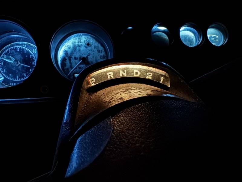

Been working on my 70 RR and cleaned up the dash and got new bulbs in everywhere, headlight switch is new and all lights come on as supposed to,
Brake lights do not work when lights on/pedal pressed
Lights off/pedal pushed all park lights turn on
Gotta be a wire crossed possibly or bad ground? Any help would be greatly appreciated
