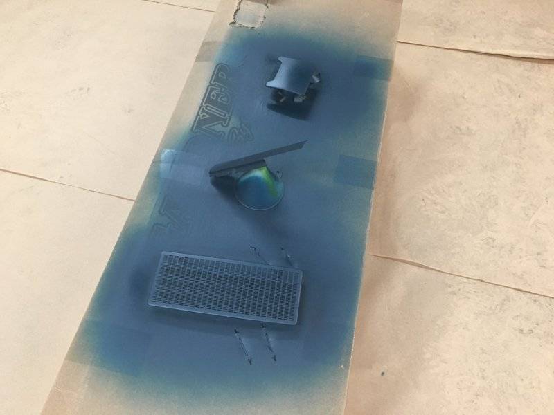

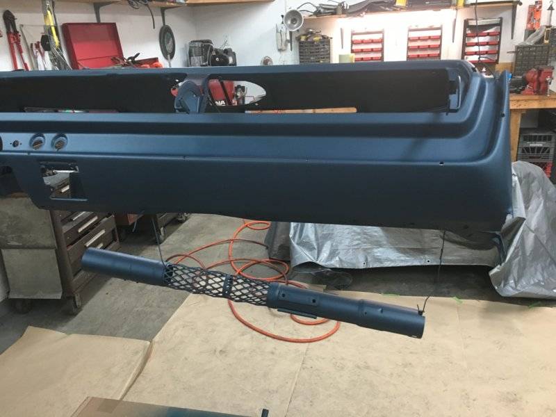

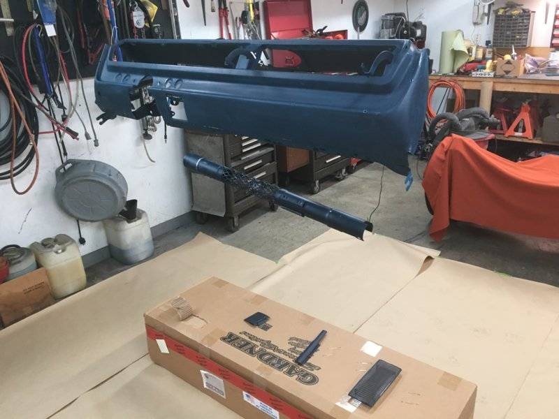

This is Shop Line base coat engineered with the texture and right color for the 67. Used my cheap Titan spray gun. No primers or anything, 400 over original finish. No rust or bare sports either. Since it's an interior finish it won't get the elements like the exterior.
Before
After
"base coat" usually implies a base/clear combo. So are you shooting a clear over it ? For texture I'd go with a single stage. Shops will mix it but their minimum is a quart !!
No clear coat. The local PPG jobber here works with one of the big Mopar resto shops and they came up with a textured base coat formula to replace the old lacquer. Shop Line base coat can be left open (no clear) on interior applications. I did use it on my steering wheel, smoothed the texture with 800 and shot semi clear on that.

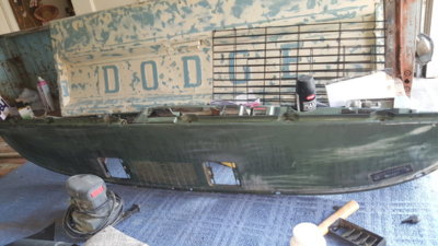

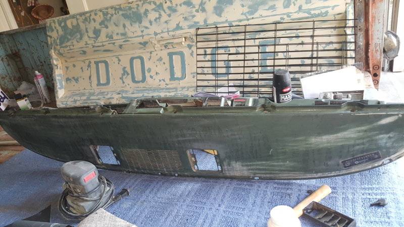

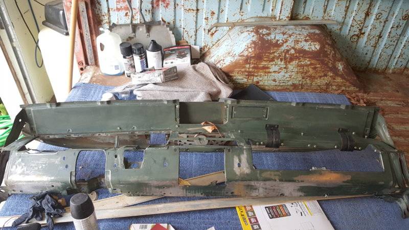

Thank you for all the responses. Heres a pic of my dash. It has a few spots where its down to metal due to rust. im not finished prepping it. I hit it all with 220 first

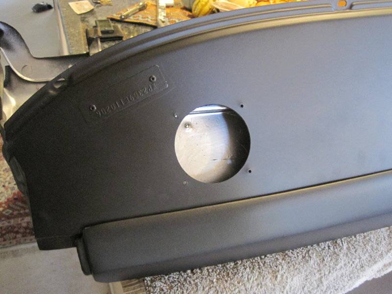

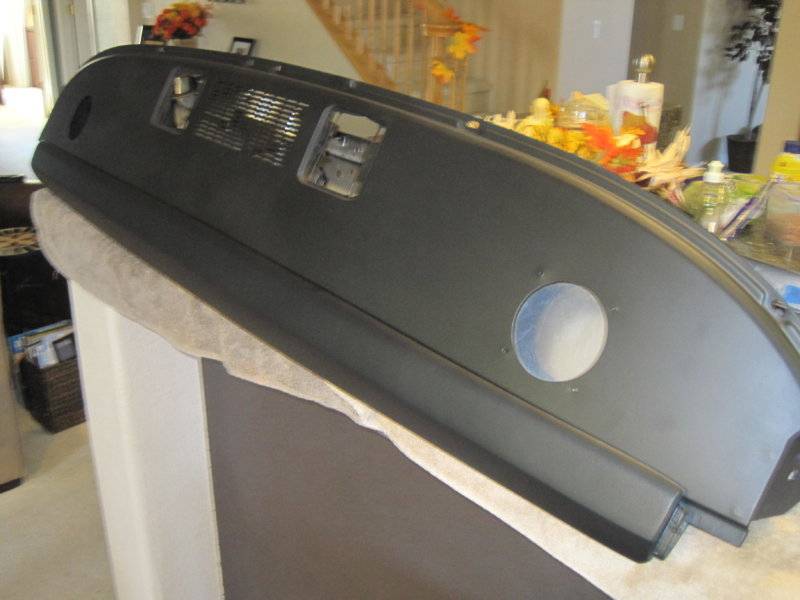

When restoring the Coronet, the dash had so much surface rust I had it media blasted. Down to bare metal I used SEM rattle can etch primer and top coated with John Deere Blitz Black rattle can. The JD paint has a slightly rough texture that comes close to the factory suede finish.
Another tip I picked up from a FBBO member was to paint the underside a contrasting light silver to make it easier to see the wiring harnesses.
