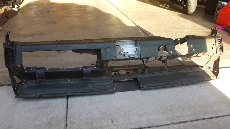

Hi everyone looking for some help.
I recently got the ball rolling on my 68 coronet. Since the painter has my car i decided to get started on my dash. Its going from green to black ( exterior paint will be octane red) the frame of my dash has.some surace rust and the slightest pitting. Can someone please give me the proper steps to get this dash prepped for paint. Oooor do people usually go with powder coating?

Just proceed as though it was the outer body for prep. I would recommend a rough/flat/semi-gloss finish for the top.
Mike
If not going with originality then I would Powdercoat it......
If you have to fill the pitting then powder coating is not an option - the powder will not stick to filler.

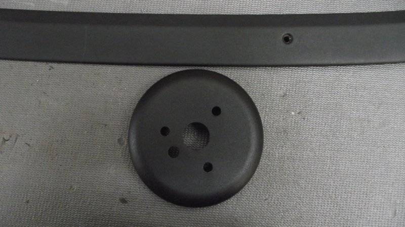

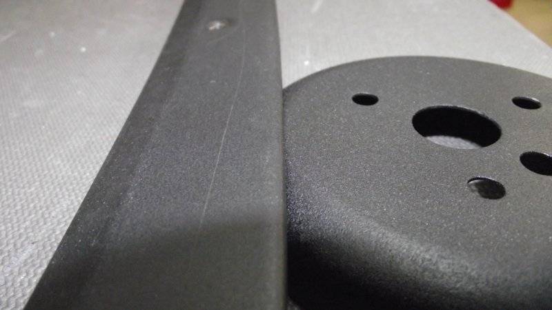

When I did mine (black) I had it dipped and it got all the rust. I epoxy primed and filled it and then painted it with textured paint. But I ended up sanding it down and redoing it 3 times before I was satisfied - I couldn't get an even texture. Also, the texture will be too coarse by the time you've shot on a couple of coats so the trick is to first shoot it with flat or semi gloss black and then a quick texture coat.
The Rustoleum textured black available from Walmart is a perfect match to factory.
Factory on top - new paint on bottom
factory on left - new on right

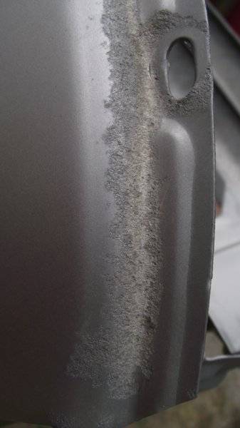

the pitting I had to deal with
Carefully sand blast it,epoxy prime and paint it.You don't have to be fancy in too many places, just get it covered.Then focus on the ends by the AC ducts,across the bottom and of course the top. Not much else shows on these.
You can have it (or do it yourself) powdercoated but there are a ton of nooks and crannys to try to get powder sucked into. I am not saying it can't be done but you would need a couple sets of eyes and good lighting to make sure it was covered.
Carefully sandblasting means dusting across the speaker grill and top,don't spend a lot of time up there.
If there is corrosion along where it bolts up,you can do that a little better because there is a bend line along there.DA or hand sand the top if needed.
Just don't spend much time on the top or you could warp it although most of these mopar dashes are thicker than GM or Fords.

Blasting doesn't do squat for rust pits, the grain isn't fine enough. Soda doesn't touch rust.
Yours doesn't look too bad. I'd hand sand it, ese metalprep or similar to get rid of the rust, prime and fill the areas then prime and paint the whole dash. These were never primed from the factory - the color was applied to bare metal. I'd give it a light sanding - the original paint will provide a good base.
